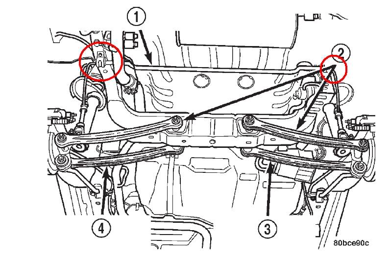

Thanks man...are those for the rear or the front? Because I thought the rear just needed endlinks and that was it?
Old Oct 26, 2007 | 11:46 PM
GrApHite03's Avatar
GrApHite03
Joined: Oct 2005
Posts: 2,019
From: Honolulu
Default RE: srt sway bars
rear...
