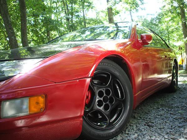

it does if ur good at it and clear coat it my friend did it on his 300zx
