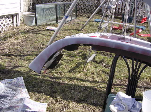

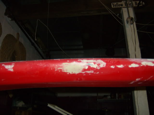

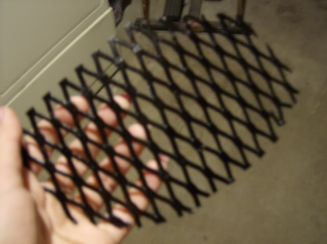

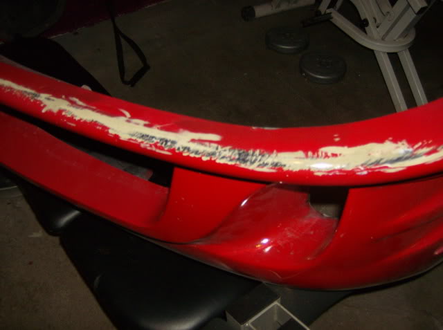

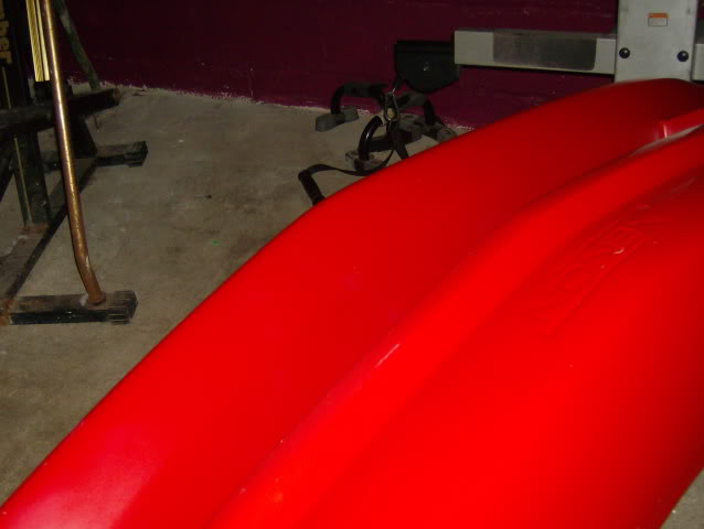

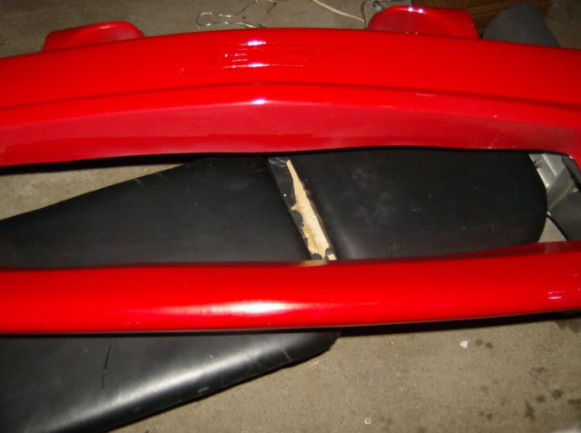

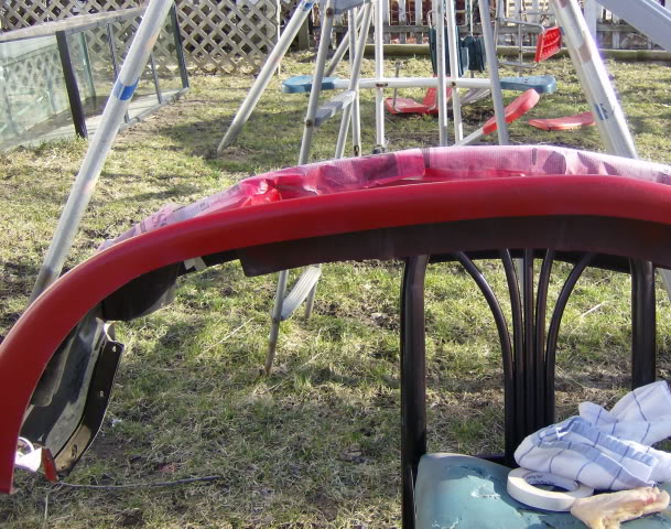

I decided to work on my scraped up Xenon bumper this weekend. It was nice out (not warm enough to paint but I did it anyway). So far, so good I still need to put a few more layers of clear coat on it.

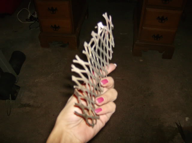

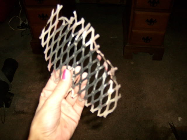

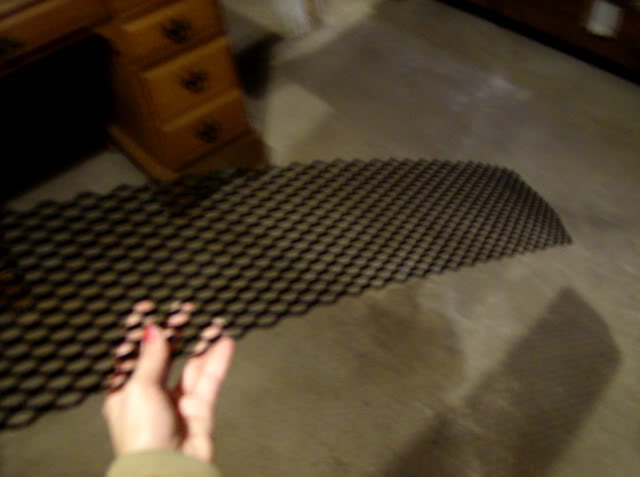

First, I had to remove the mesh for repairs. They were all bent up and rusty lookin so I hammered them out, sanded them down and cleaned them, then painted them.
BEFORE
AFTER

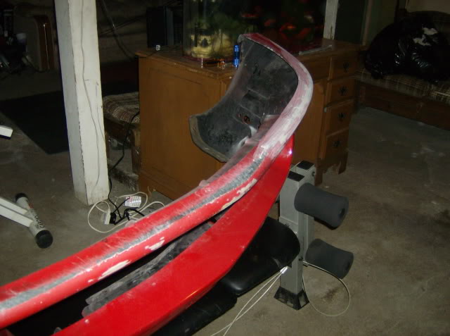

Then I put putty on the bumper and sanded it down.

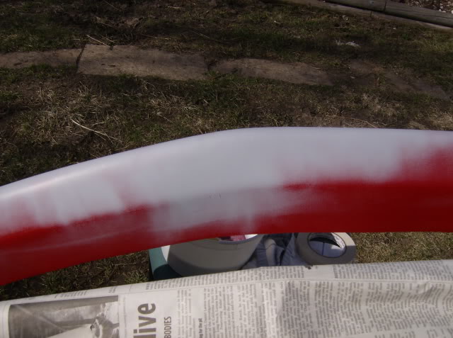

Next I primed and sanded it some more.

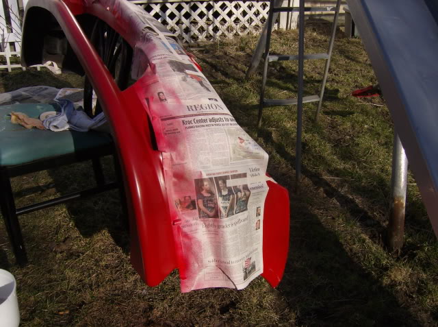

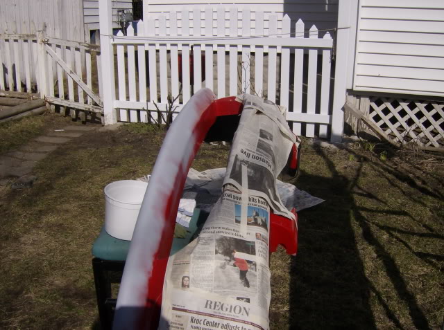

Then painted it...

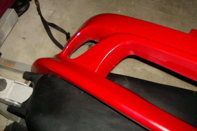

Final product:
I'm still not done tho [&o] I need to put another layer of clear coat on it, at the moment it doesn't look glossy enough. I have to wait until Saturday for the paint to cure before I can do that. Hopefully it will be done by next week so I can put it on along with the new wheels [sm=bounceybounce.gif]
