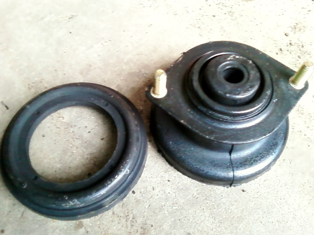

-Yeah, I'd definitely replace the strut mounts. I replaced the rear suspension on my Mother-in-law's '92 Toyota Paseo that was sagging and was making all kinds of noises when she was driving. This is what the strut mount is supposed to look like.

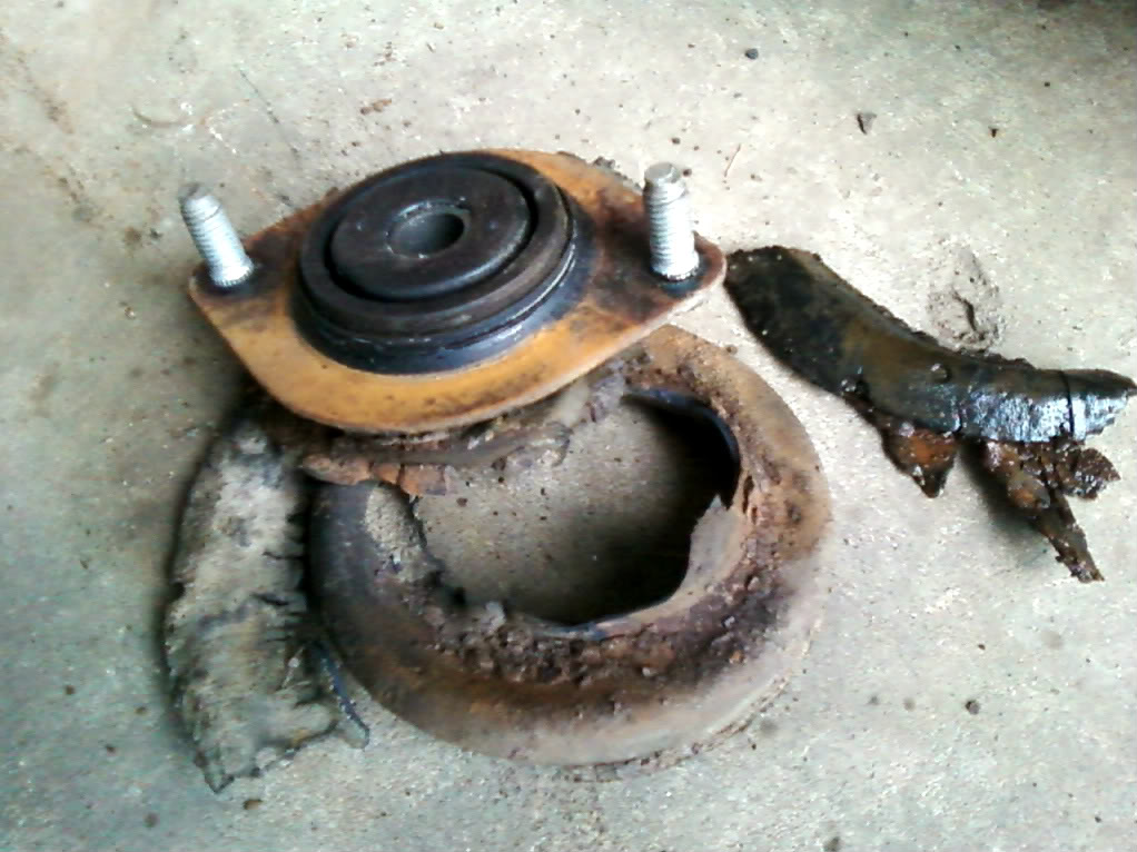

-And this is what it was like when I pulled it from the car. Now I doubt that yours are this bad, but if the bearing plate wears out, you'll get some squeaking and knocking when going over bumps. Especially if you're turning into a parking lot.
