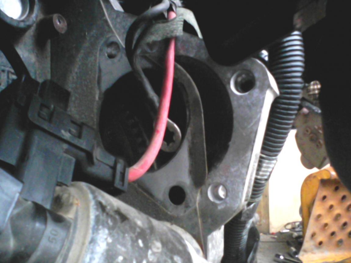

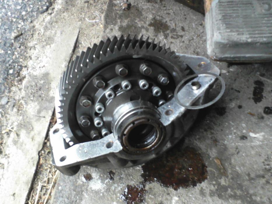

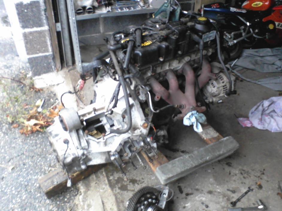

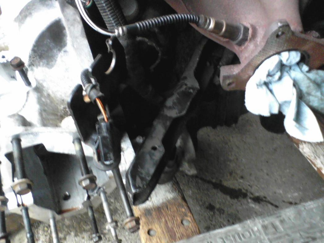

Dry fit today with pics. More pics later, I exceeded forum limit have to use my ftp instead.
Attached Thumbnails How to 2004 LSD swap a 2gn neon?-assembled.jpg   How to 2004 LSD swap a 2gn neon?-bracket.jpg   How to 2004 LSD swap a 2gn neon?-posi-baby.jpg   How to 2004 LSD swap a 2gn neon?-starter.jpg   How to 2004 LSD swap a 2gn neon?-trans-mount.jpg
