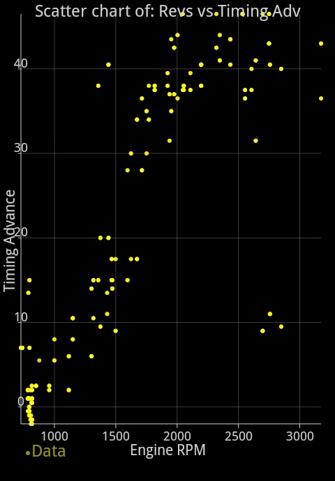

I had a friend come over and looked at the data streams with Torque for android, and went for a drive. Brought up the ignition timing , and it showed at wot it was 40.5 degrees advanced. does this sound right or a possible error? that seams a little high to me. i am thinking that possibly this belt is off a tooth. I was reading somewhere else on this forum that 1 tooth on the cam gear equates to 20.25 degrees of timing. So 40.5-20.25= 20.25 one tooth... coincidence?

Hard to say exact values. The PCM adjusts the timing based on several conditions/factors. However, based on other info I've seen, I'd say that could be a bit too high.

here is a shot of timing advance and rpm i took earlier with the torque app

I'm not convinced that your ignition timing is that far off. For example on a small block Chevy total timing is around 36 degrees.
