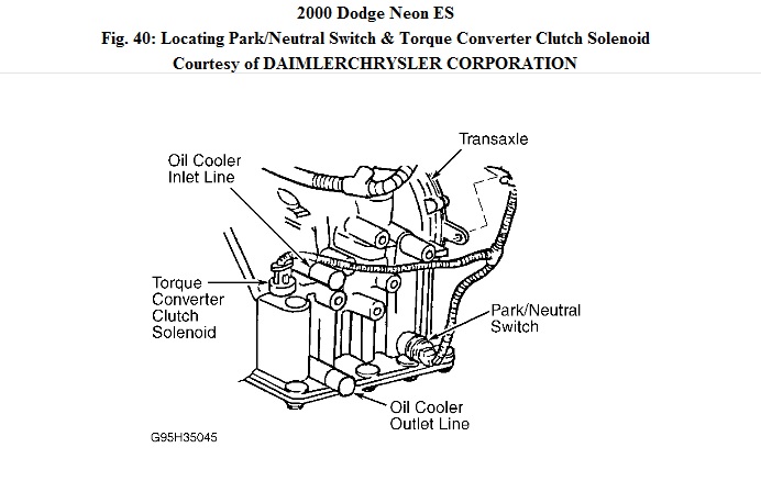

Question helplease
darth could u help? could u tell me wher it is located please

ETA: Looking at the wiring diagrams, you may first check fuse 7. It is a 15A fuse that should be labeled as the rear defroster fuse. The thing is, that fuse also controls (in part) the neutral safety switch and back up lamp switch (which is part of the neutral safety switch).
You have a 00-01 Neon (non-electronic transmission), IIRC, yeah? It's a three-prong connector.
