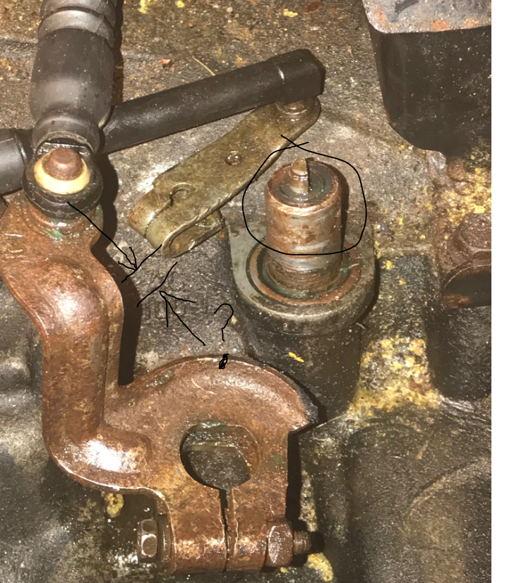

--well, what I did(and I may have really messed up here...) I had my helper make sure shifter was in park, I made sure shift linkage was in fully counter-clockwise
position: (the circled portion below)
Hooked up linkages, and had helper run shifter through all gears, as I watched linkage..
But I'm thinking just because that linkage "looks right", doesn't mean what's going on below is correct...
