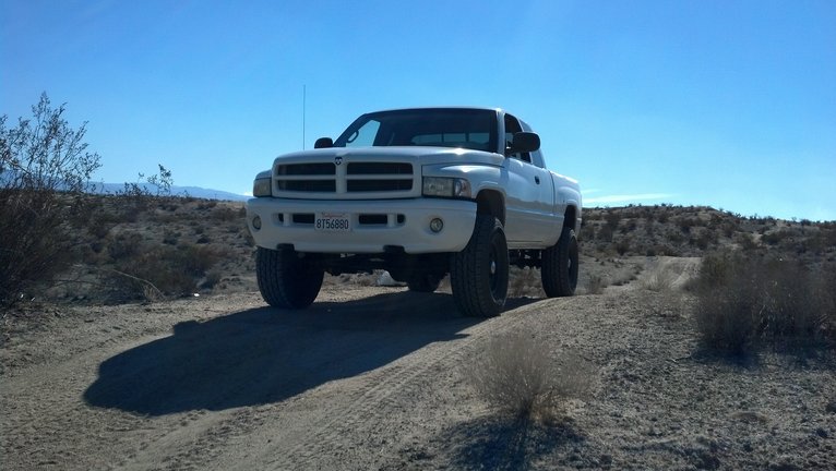

Running 315 75 16 (yokohama geolander A/T) on a 16x8's.
Equates to a 34.6" x 12.40"
Im not sure about the suspension as I bought her this way.
