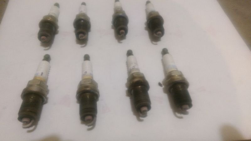

I've got some NGK IZFR6K13 Iridiums in, gapped to .058", and fed by a DUI Screamin' Demon (45kV secondary voltage) coil. { ... }
Finally! I've got about 24,000 miles on those plugs and gave 'em a good looking over.
Color's good and the gaps are all dead nuts right where I set them (0.058") four and a half years ago. Guess I'll look at 'em again in another 75,000 miles.
I'm calling the experiment a success.
