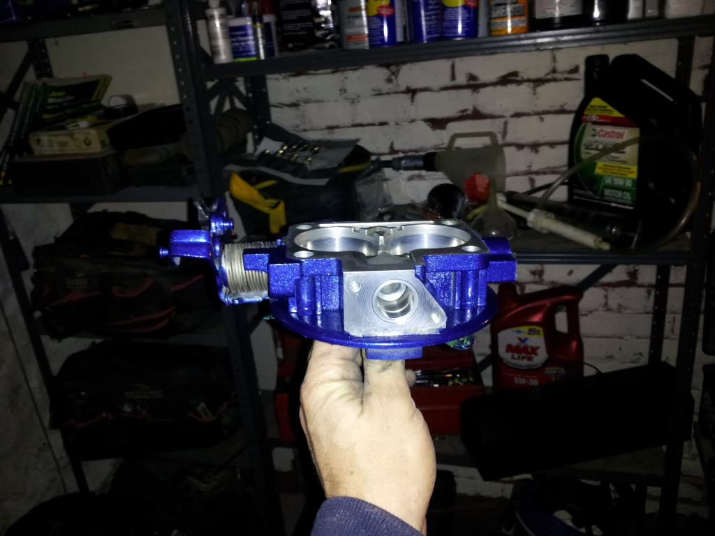

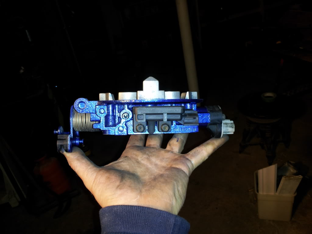

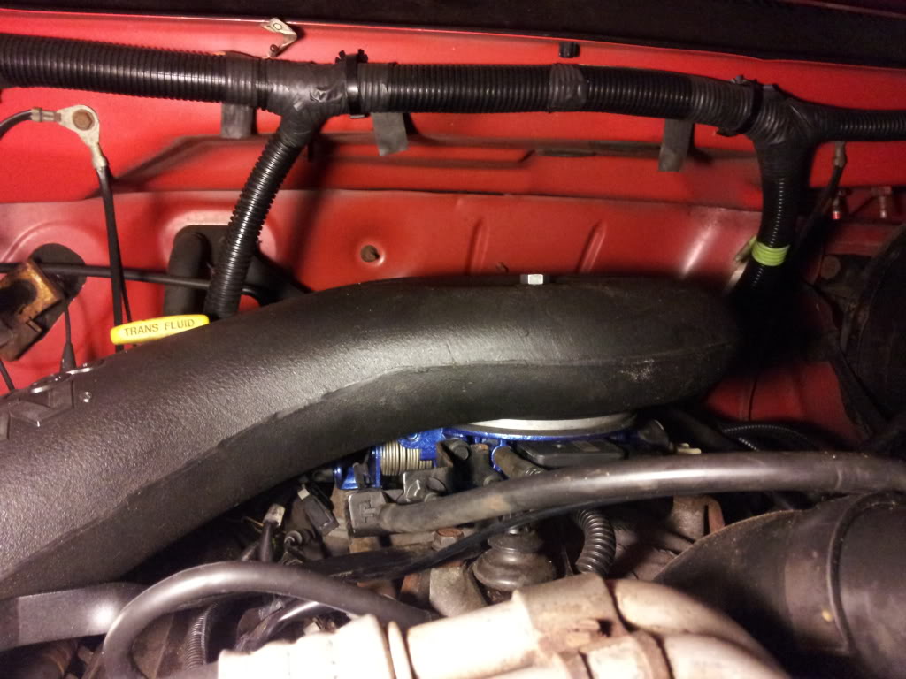

Cleaned mine up today...also went the route of disconnecting the linkage mount from the TB.
I had a little metallic blue high temp paint in the shop so I decided while the TB was all nice and clean i'd paint it up. The TB was in my hands in 10 min. or less...ofcourse cleaning it up took a bit longer

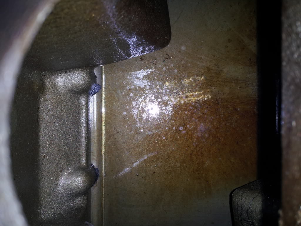

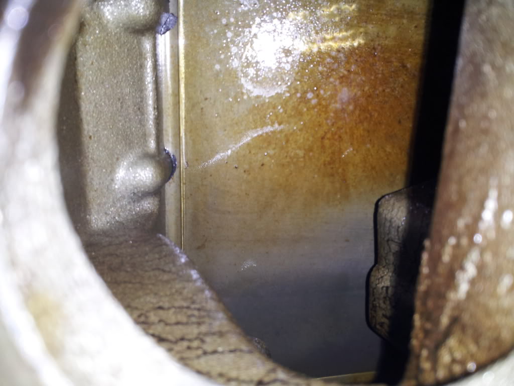

Also appears my Plenum is in good in enough shape to get me through a until the M1 Goes in it...Few weeks.
