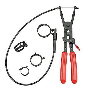

fixed it saturday afternoon. Replaced both the upper and lower radiator hoses.
also got sick of using pliers on those stupid hose clamps and finally bought the right tool for it.
they make the job so much easier!!!
though that big hose clamp you gotta be careful with cause it can close down too much when it is not on a stiff hose that it will have the fingers spread too far apart for the pliers to grab, and then you gotta use channel locks on it to be able to get the proper clamp pliers on it.

The Right Tool For the Job

I made my own pliers for it. Works like a champ...
