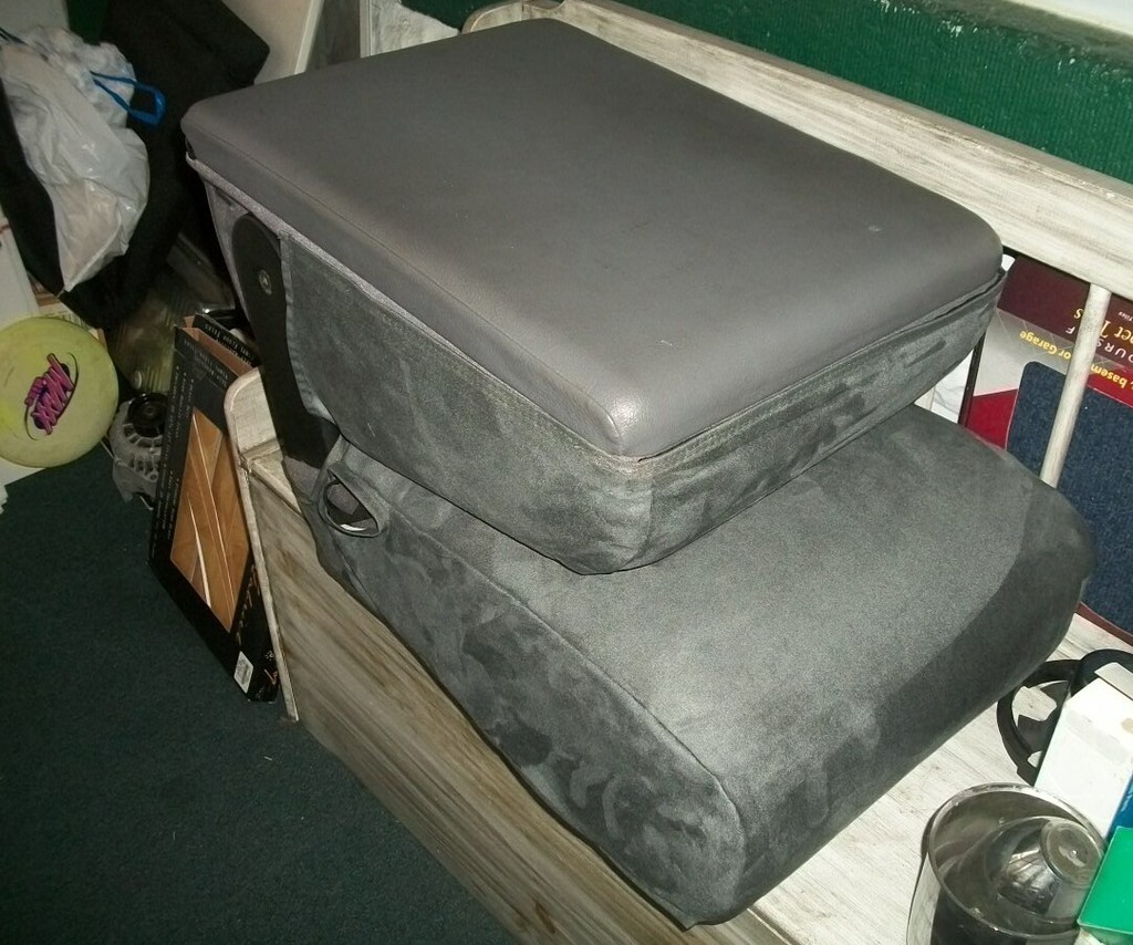

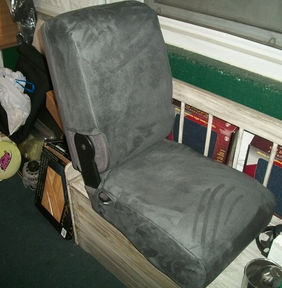

installed the precision fit seat cover to the middle seat today, pretty nice fit but it still needs to relax a bit from being folded up in the box for the last 2 months

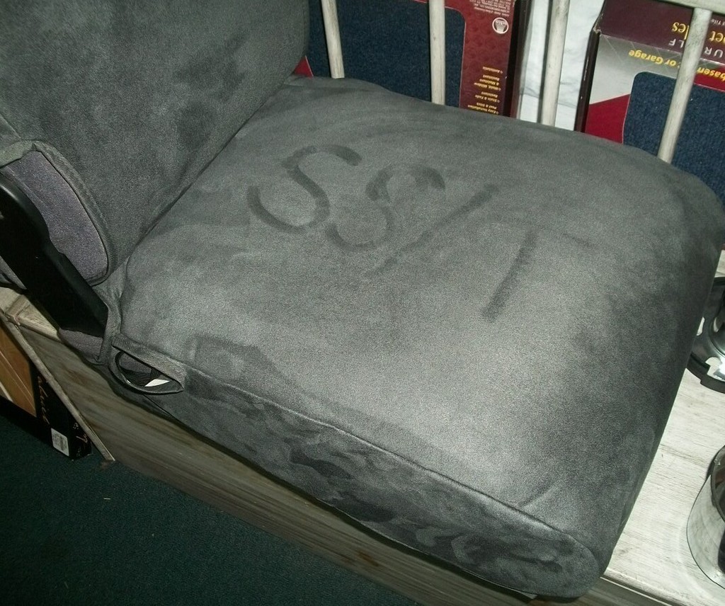

the material is pretty cool so I had a little fun

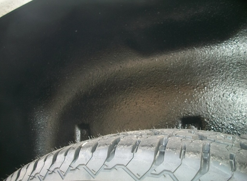

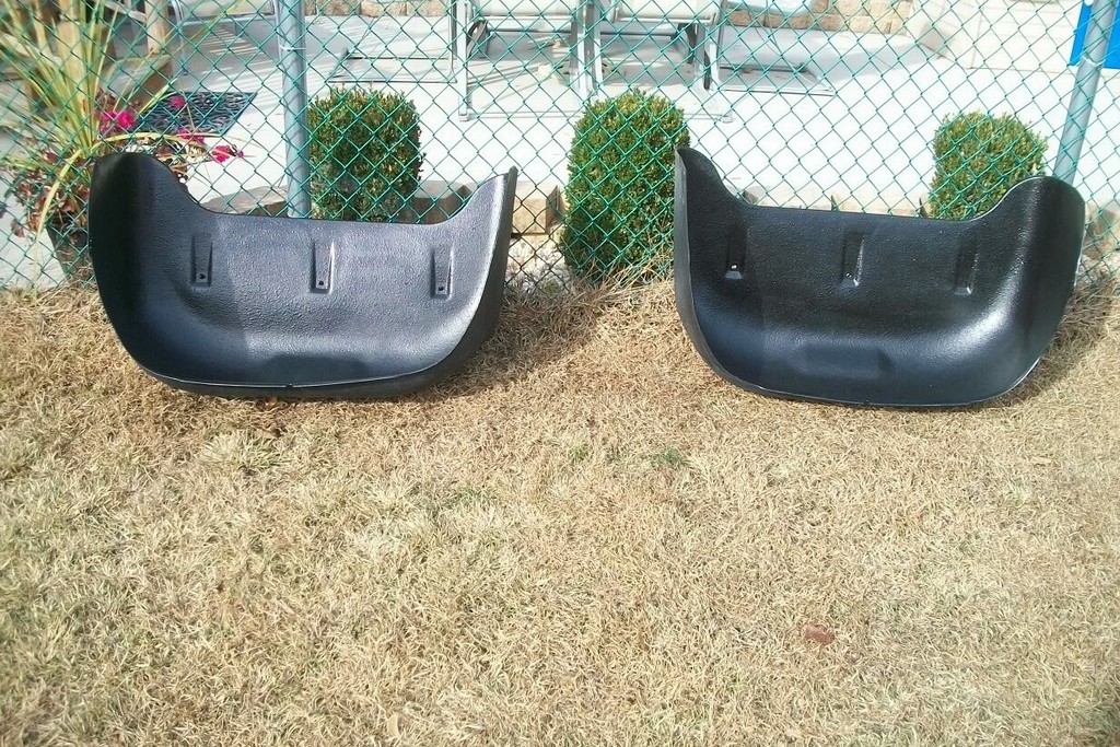

a while back I scored these in the u-pull it for $10 for the pair-- some power washing and some fresh black paint and they look like new... don't think I posted them

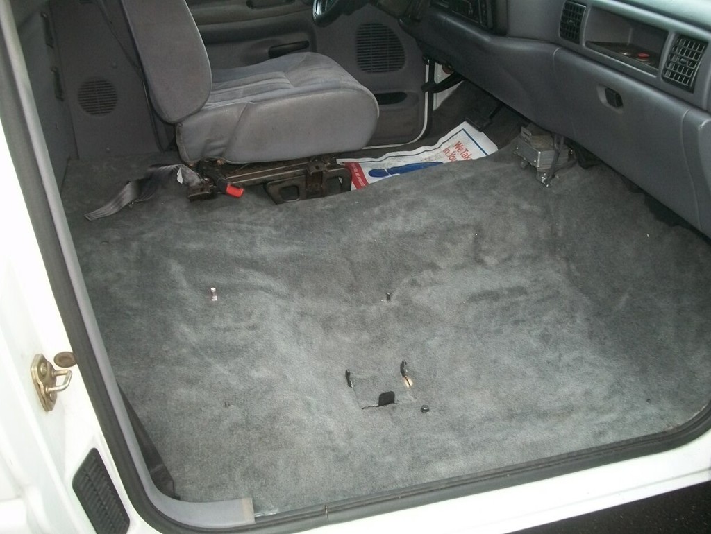

carpet is in, just needs minor trimming in a few spots so I can put the sills back in.. with any luck rain is over ( feel like I live in seattle lately) and I can start
putting her back together today..
