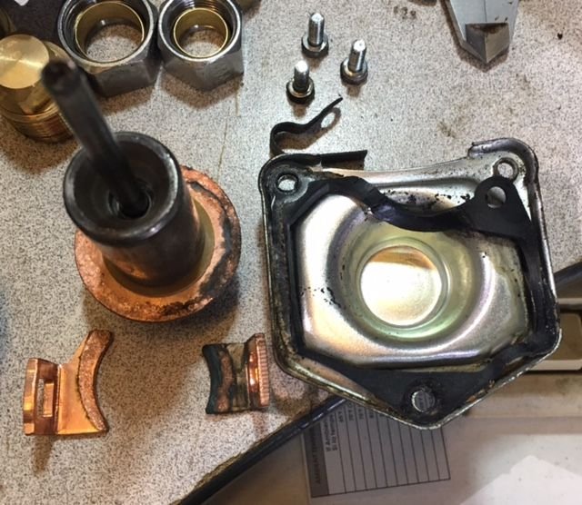

Finally got around to changing the starter contacts... they weren't as bad as I expected.
I was supersized to find the cover seal was not correctly positioned when the starter was built.
It had hardened into this shape due to heat exposure over time.
So I soaked it in hot water for a while to soften it, then tried to reform it... it was springing back a little, so I tacked the offending areas with a little hot-melt glue until I got it screwed down.
The intermittent 'click' and no crank on start seems to be rectified... though with that little wear, I wouldn't have expected then to be the problem.
