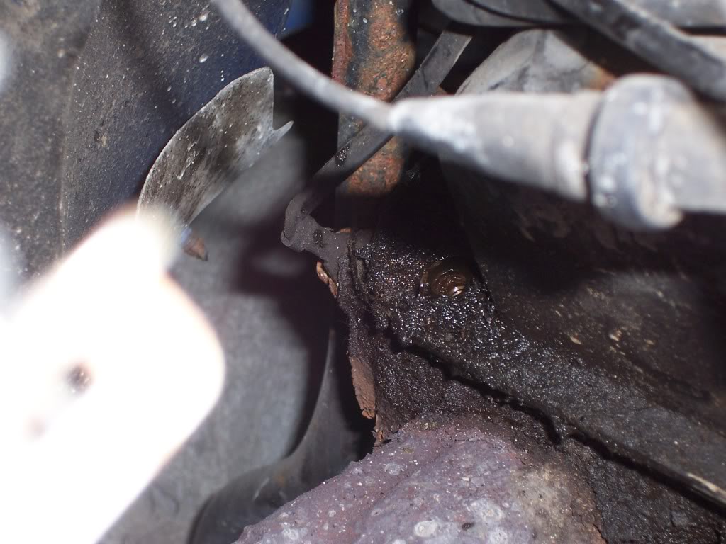

I would suggest tightening the valve cover bolts, and cleaning up the area with brake cleaner. About half of the bolts on mine were less than finger tight, which was causing the same problem you are having with the oil on the exhaust manifolds ect. I ended up replacing the passenger side gasket, and it stopped the leaking for good.
yours is not as bad as mine was, here is a pic
