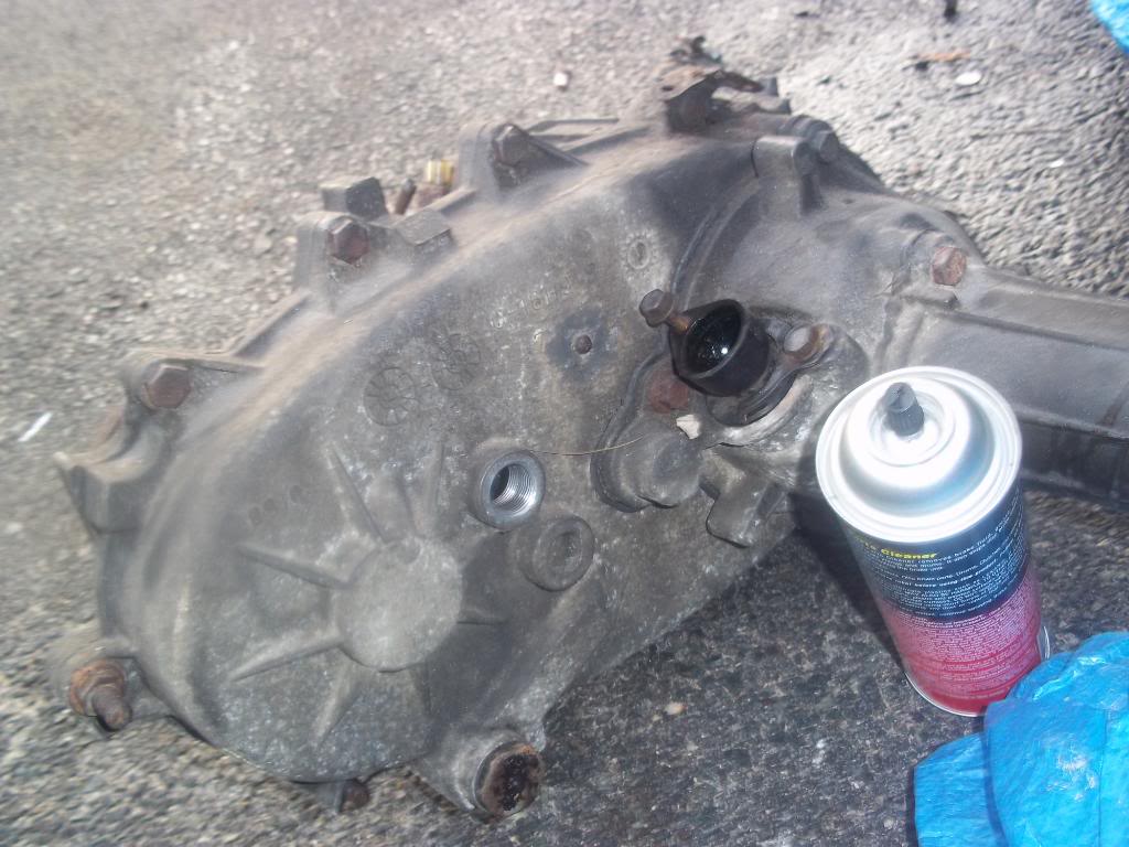

well finally after over a month Ol' Blue is back on the road.
First off heres pics of the old T-Case....Look how crooked the chain is. And i couldnt get the shaft to move to straighten it out....and i had lots of chuncks of a gear in there....def. blown.

Now for the New T-case. Its a very clean case....Absolutly no cracks like my t-case had. Went over the entire thing, and not one crack.

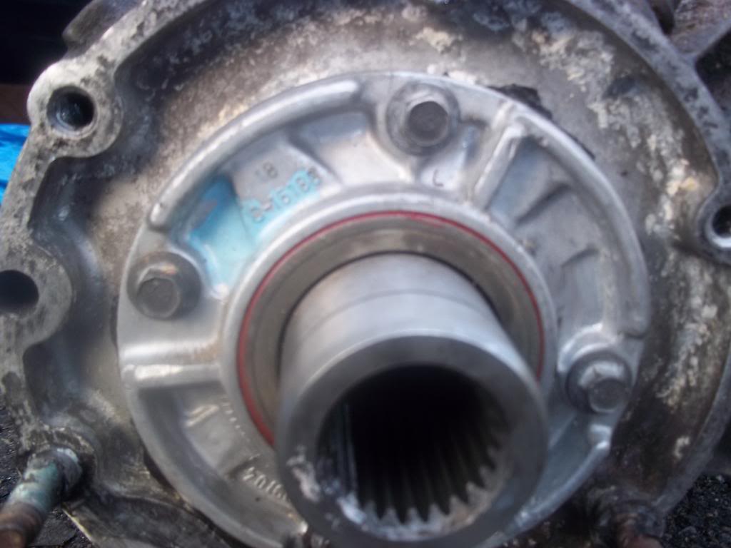

And luckily it has a new seal with less than 10K on it.
