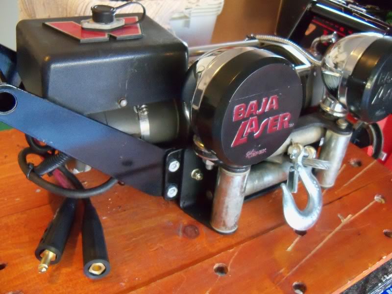

Where the hell are you finding welding A/C cable for $5 a foot? My local welding supply sells 2 gauge for $2.69 a foot and it's just over $2.50 at my local Ace hardware.
Amazon.com had some in 10' rolls for about $22 shipped last I looked and ebay had some listed for around $1.55 per foot.
The pound on ends run about $5 per 8 pack and the screw lock type run about a buck a piece.
Another thing I found at my local welding supply shop was quick connects. Warn wants like $70 and this place had a very secure, twist lock type for wire from 6 gauge all the way to 2/0 for $9 each. Great for portable winch mounts:
