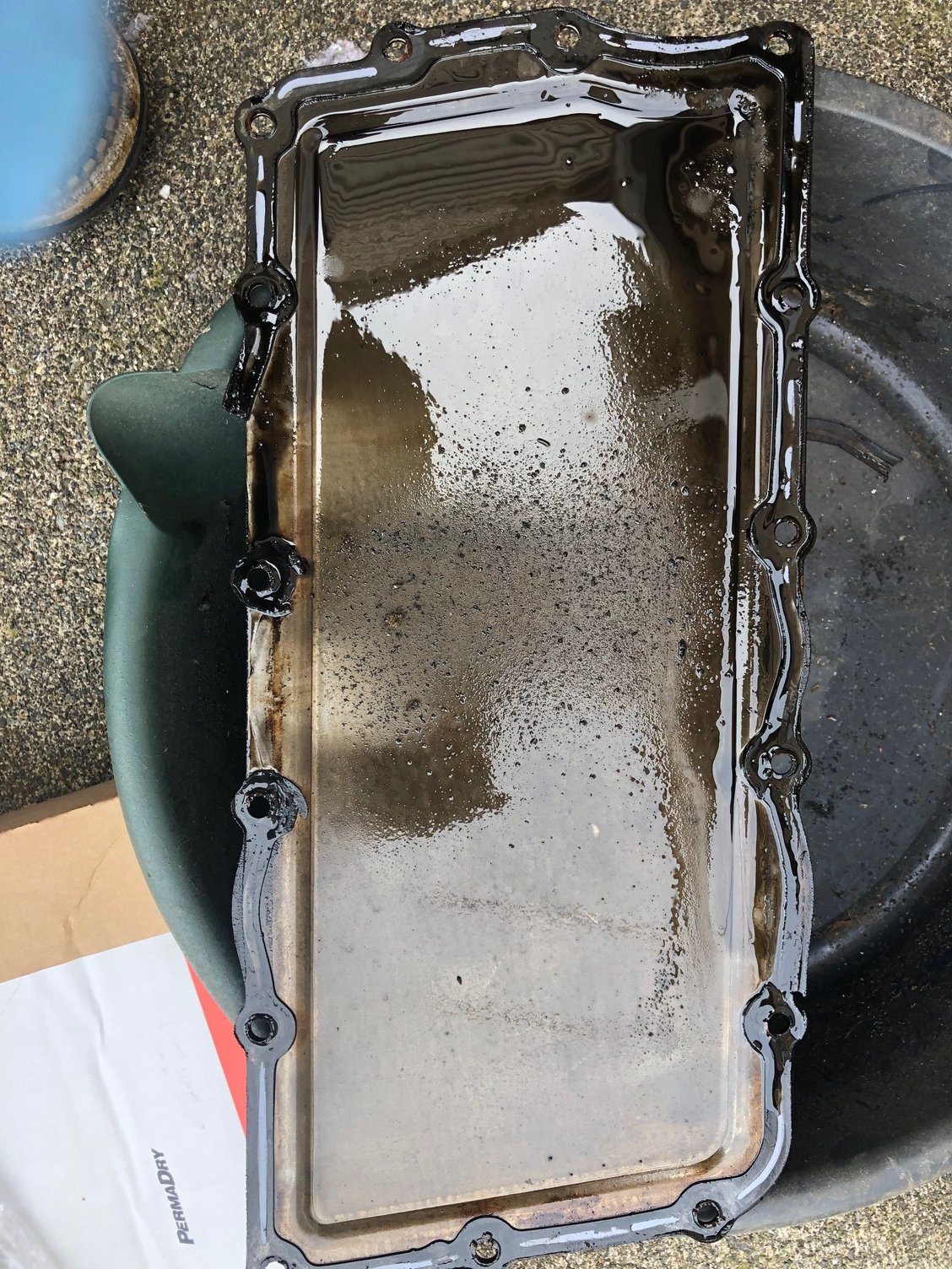

Posting mine up. Symptoms include: marble sound under load, excessive oil consumption (1 quart every 100 miles), general lack of power. Hoping to see if this fixes the issue. I am replacing te PCV valves and the valve cover gaskets
