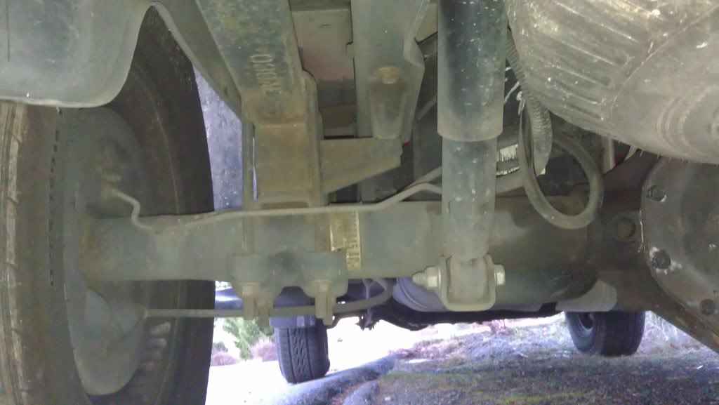

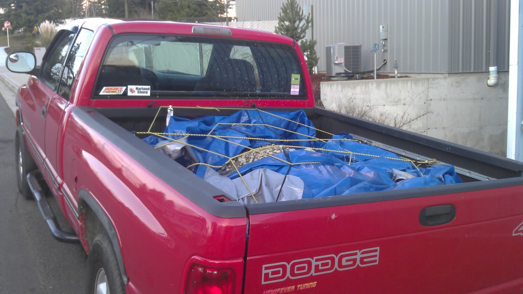

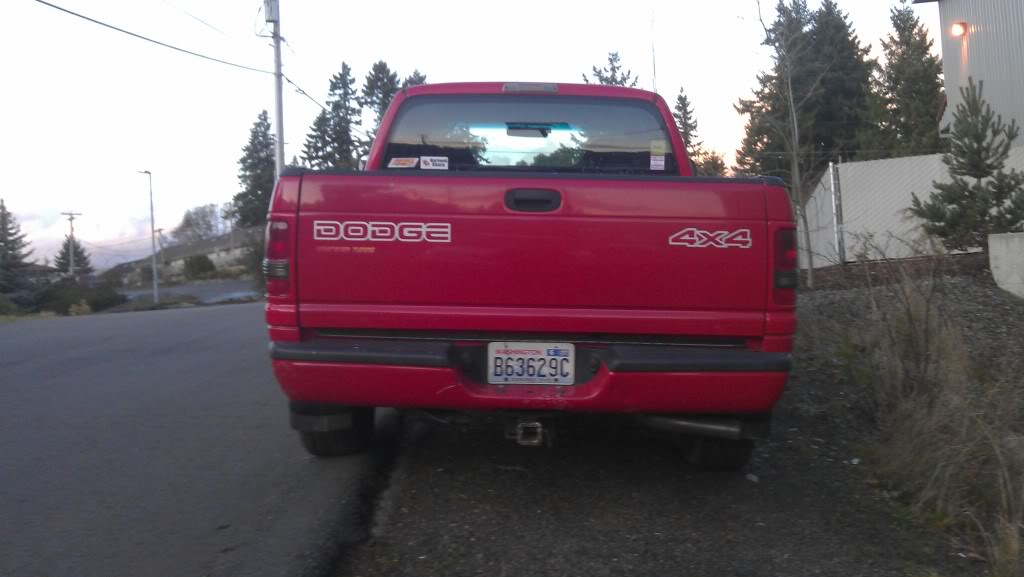

Headed to the local gravel pit today and over loaded a tad. So I think I know the answer already but what is likely to be damaged from hauling this much weight and would air bags be a good idea for a 1500 to allow heavier loads?

Oh yeah, she's bottomed out.

i don't think you where too over weight. with my truck empty i can legally haul about 1800 pounds in my box. since you have an extended cab i think your GVWR would be a tiny bit higher than a regular cab long box or short box. i guess as long as the truck did not weight more than the GVWR you will most likely not break anything.

If you are resting on the bump stops, and they are compressed some..... Yeah, you are overloaded. Don't go far, don't go fast, and watch the bumps. Should be ok once in a great while... but, don't make a habit of it.
It isn't just the suspension that limits load carrying capacity, its also the brakes..... you need to be able to stop whatever you are hauling around. The half ton truck doesn't have the best brakes to begin with.... overloading it like that puts you WAY beyond their capacity to control the truck. Air bags may keep you off the bump stops, but, they aren't going to make your brakes work any better.
You would be better off renting a trailer, and pulling the load, rather than putting it in the bed.

BTW to the OP: based on the pic I wouldn't want to drive around like that. With that particular loading, even if all the components were within weight rating which seems unlikely, that thing looks like a road hazard. With it riding all nose high like that the handling is going to be terrible, especially in an emergency maneuver.

Agreed, shoulda shoveled some out cause I didn't stop the loader in time as the gravel was saturated with rain which made me heavier than the last time I loaded. This was the last trip of running gravel in the back of the truck, don't like the way it rides and don't want to hurt anybody or the truck, the tires probably were the weekest point, would hate to have a blow out, the weight could do a lot of damage to the axle, or like you said, an emergency maneuver would be very dangerous or impossible. I drive a 1 ton Ram Cummins flatbed at work and that truck could haul some serious weight, I would put 2 pallets of dry readymix concrete 3500 lbs each and it did fine, still up off the spring stops, although way over GVRW im sure. Thanks for your comments, safety should be number one. It's good to know the vehicles limits before loading up and heading down the road. Let this be an example of what not to do with your Ram 1500!
