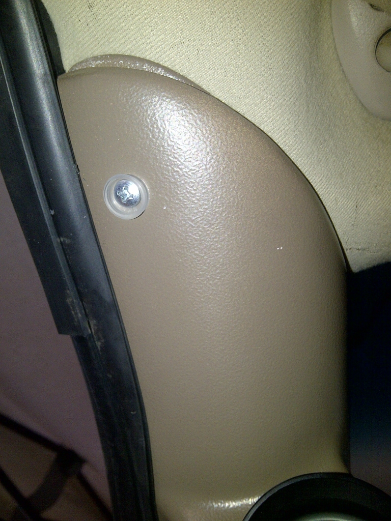

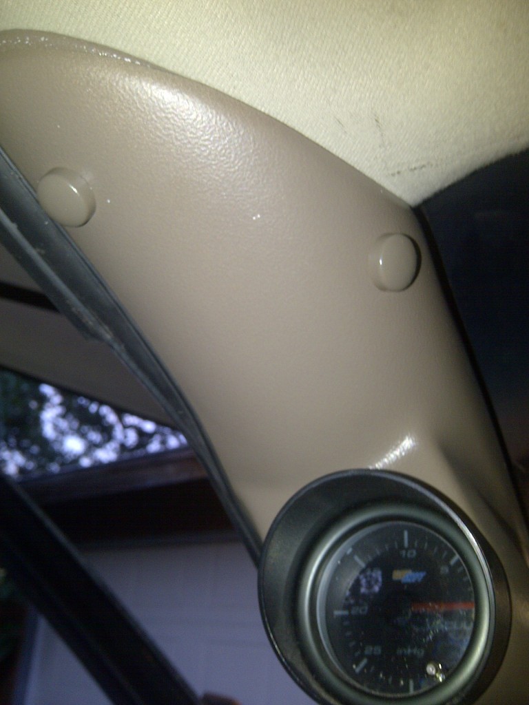

Since the 100 degree heat appears to jack with the adhesive on Velcro and allows my A Pillar Pod to drop down, and threat of rain prevented me form spraying bed liner, I decided to tinker with this problem while flushing coolant system.

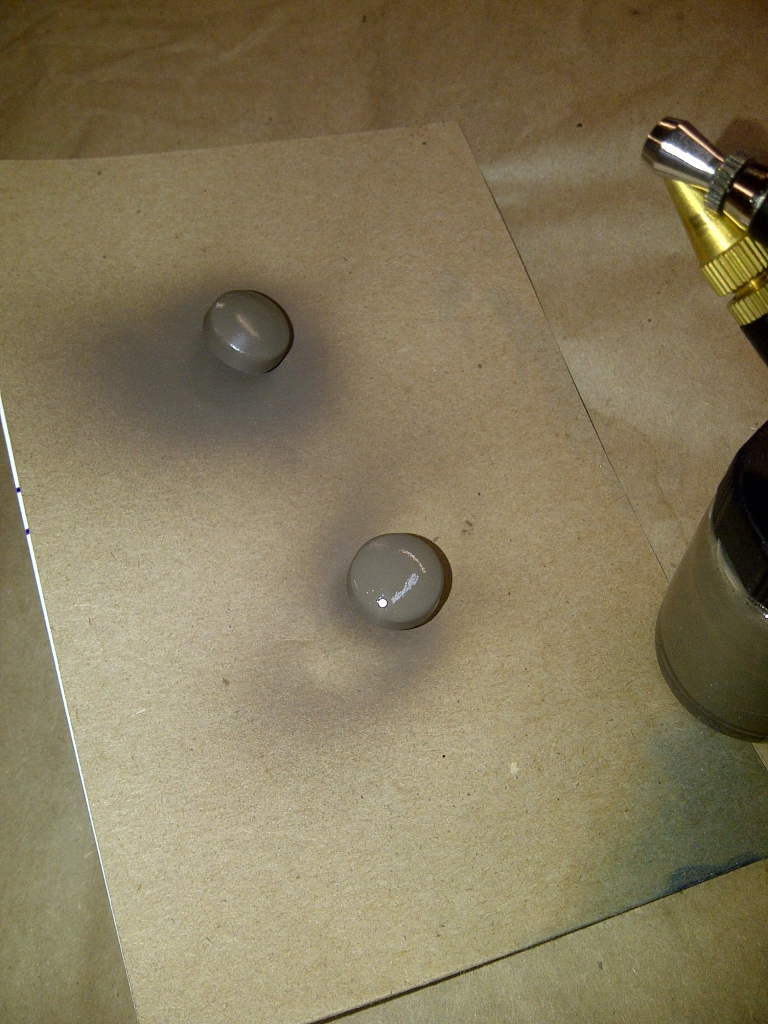

I found some license plate hardware in a box where I keep surplus small parts. One set has a plastic cap to cover screws with a plastic base that it snaps onto. The only problem – they are white…or were….Nothing a little airbrush work can’t fix…

I hope this solves the problem. Due to brittleness of original plastic pillar cover, I drilled a very small hole to begin, then larger hold. Drilled small hole into sheet metal behind for screw to grip into.

Looks good. If the screws got a good grip in the a-pillar metal, I think that will work just fine.

Drivin garound town for two days now, and with the rough roads we have here...still secure. Liking it!

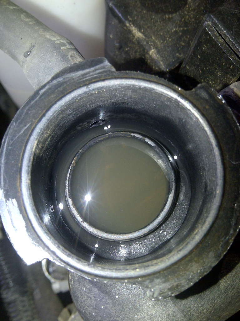

So I pulled radiator cap off this evening to peek inside:

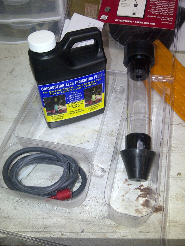

Combustion gas analyzer came in today - perfect timing!

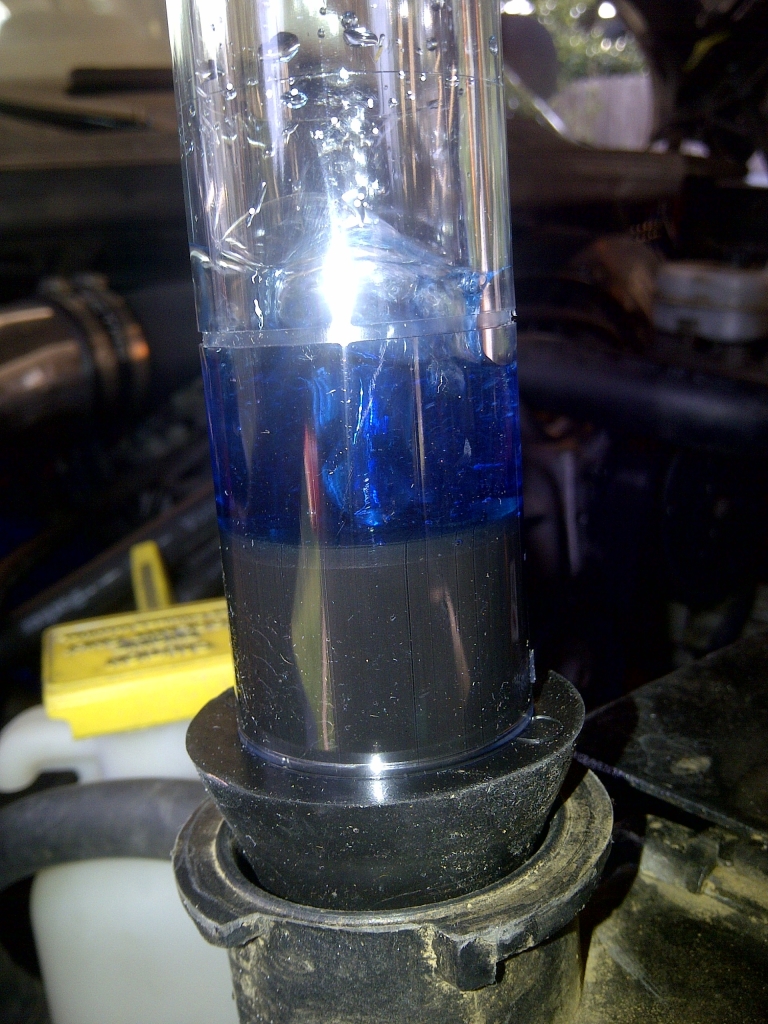

AND, testing radiator with tester, engine running, vacuum line draws air (note bubbles) from radiator into test chamber. If it reamins blue, all is good. If it turns yellow, it is rebuild time!
So, there is no combustion gasses present. Brown crud must have been left over from previous flush, without adequate rinsing from system.
Time to drain system and refill with water and coolant.
