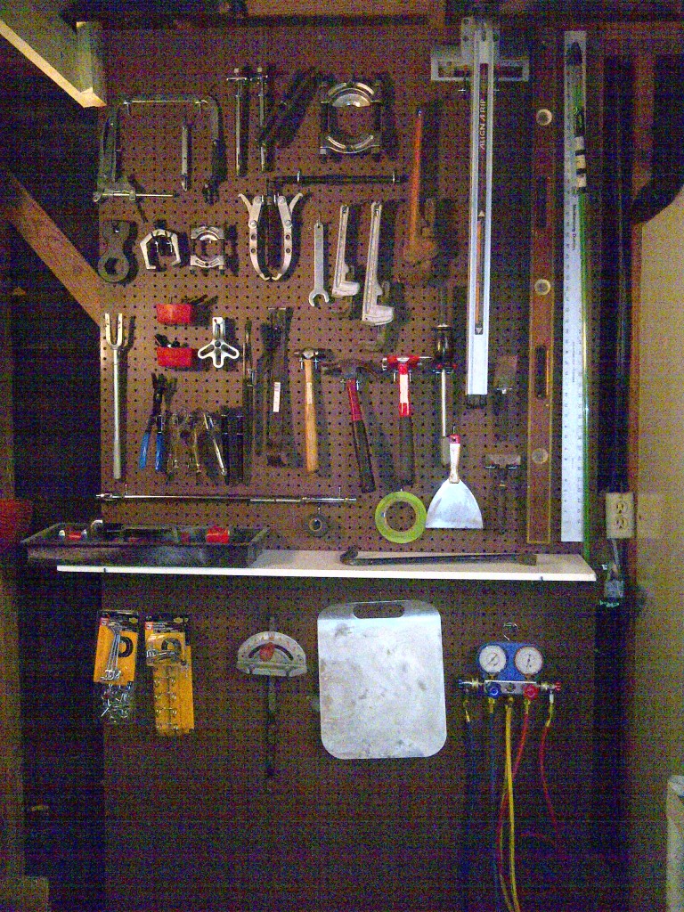

And I put this up today and started hanging tools that I do not use often, but is in the way of the tools I need more frequently.

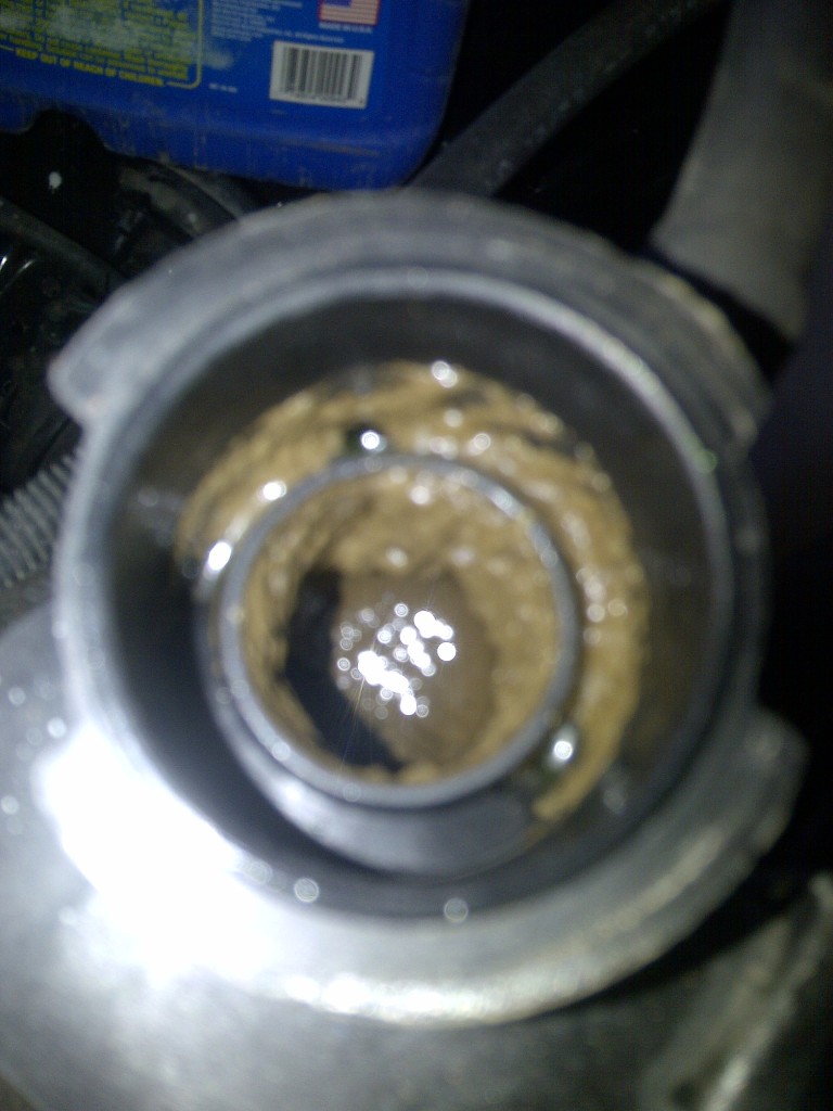

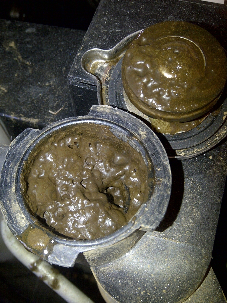

After making a 400 mile trip for work this week, decided to get back to an issue I noticed a couple weeks ago.
I discovered this. I wip[ed out waht I could and stuck a hose in to float out waht was there.
When I opened radiator yesterday, it looked worse. Radiator was changed out and system flushed several months ago (November I think.
So I ran Prestone flush through it two times yesterday, and one time today. Clean water between each prestone flush. Draining block each time as well.
When I drained the plain water from it this morning, it looked really clean. Still ran another bottle of prestone through it this morning anyway just to be sure.
As I am thinking back, I may not have run cealn water through it after flush last fall. I might have drained flush and refilled with coolant and water.......which my explain the gunk in the system. I hope that is all that it is....
And as I have been going through this process, and read a number of threads yesterday and last nigh about "engine ticking" i became aware of a barely detectable ticking sound! Holy cra*! It only shows up at around 190 degrees.
I had suspected rockers and I install HS rockers several weeks ago. So off come the valve covers and out comes the torque wrench. Rockers have about 600 miles on them now. All checked good. Cranked up, and now need to wash oil off engine......
Then I started poking around the entire engine with a stethascope and I discovered that the ticking is coming form the injectors. Should I be able to hear the injectors? I haven't noticed this before, and cannot hear it when the efans are running. Are injectors on their wayt to failure?

Posts: 1,585
My injectors have always ticked on every vehicle i have ever owned, even brand new ones. I wouldnt worry about it.

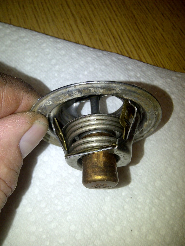

I just looked at parts on workbench (doing some work on a 64 Chevy truck for a few $) and I noticed something strange........
This is my 180 stat. I removed it when i started to flush cooling system to allow flush and water to fill and flow better while cleaning it out. It is pretty warm in the garage, but nowhere near 180 degrees though. It is a Stant thermostat.....off to AZ to see if it is lifetime warranty.....
