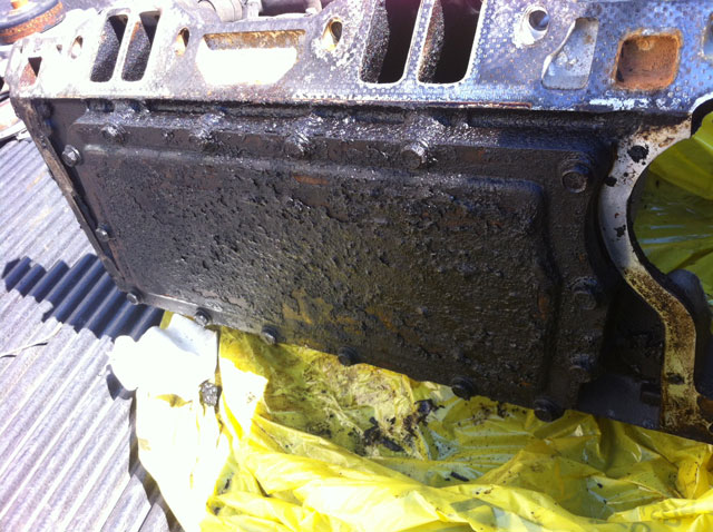

Well, my rebuild project has hit a snag. After rebuilding the bottom of the engine, we can't get the camshaft to go back in; it's too tight. Possibly one of the cam bearings wasn't inserted correctly at the machine shop?
It's a huge disappointment as things were going so well. The machine shop will make it right but my guy will have to disassemble what's already been rebuilt. I feel like I can't ask him to do this twice especially since he already has done so much free (nothing's ever free!) labor. It's a mess and I'm not sure what will happen to the truck - I've got some decisions to make.
I finally took a photo of the plenum - the reason I got into this mess in the first place.
It was blown in three places!

Did you somehow get undersized cam bearings? You are putting the cam in the correct direction, right?

when you talk about excessive oil consumption being indicative of a bad plenum gasket, what exactly does that mean? Do the trucks burn oil when the gasket goes? So if I'm constantly burning oil, then my plenum gasket is bad. Or will it leak oil somewhere? My truck burns no oil.I have not looked into the tb yet because I don't have any symptoms of a blown gasket.
Have you read the plenum thread?
The gasket is at the bottom of the intake. When the gasket is blown or because of other reasons, oil is sucked into the intake, then sent into the combustion chamber (along with air of course) where it is then burned. If your plenum gasket is blown your truck is most likely not gonna blow blue smoke, and will surely not leak externally because of it.
If you're losing (burning) oil, TAKING OFF the throttle body and looking down the intake for pooled oil is a sure way of finding a blown plenum. If it's not that's it will be something more serious; piston rings, valve guides, etc.
