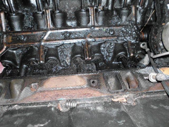

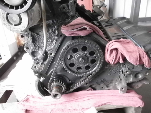

Here are a couple sludge shots:

That is pretty nasty. Im surprised that the pushrods and lifters were doing their jobs.
