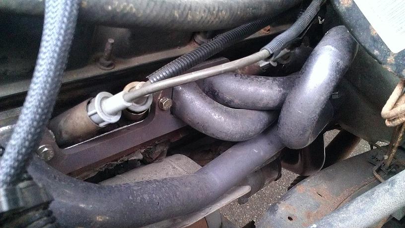

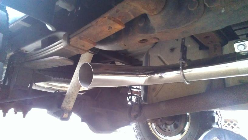

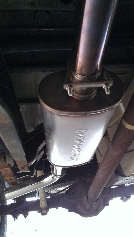

Well since most of my exhaust fell off a while back I decided to throw in some new stuff to appease the neighbors. Main purpose was to quiet her down and prevent rust without breaking bank. And since we all know that without pics - it didn't happen, I've included some and a vid with a parts list. This may take a few iterations so bare with me
Stainless shorty ebay headers (these I've had for a while)
Magnaflow 12256 Satin Stainless Steel 2.5" Oval Muffler
Magnaflow 23285 Direct Fit Catalytic Converter
2 Ft. 90° Stainless Steel Pipe Tube Exhaust 2.75"
Dynomax 33241 Stainless Steel Strap Band Clamp
The Magnaflow cat fit very well, I recommend it. There were some gaps between pipes which I expected given this wasn't a kit. What I found worked really well was the 12" x 1" stainless metal strips you can buy at ACE at different thicknesses. You can get a really tight fit and a finished looked with little effort.

Yeah I contemplated welding everything up; I figured I can always go back and do it if it gets loose or leaks. But my welder isn't setup for stainless at the moment and it'd be a bit of investment for me to get it there for a few inches of weld. Just didn't seem economical at the time. So far so good anyway.
If I get motivated I can get another clip, but what I have posted already is about it. It's pretty quiet.

Yeah so far positive reviews for me. I do like that it's a fully open design; I should have taken an end pic but I think their website probably shows it well enough. Good sound etc. The real test will see how it holds up this winter.

Well you did save some weight on the bright side. I chose to do it this way solely to save pipe cost. Plus I had duals before and didn't mind something different.
