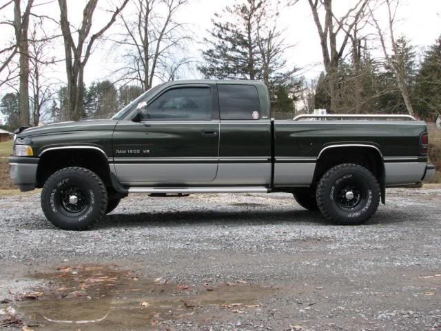

Do you guys think this add a leaf kit will make my truck perfectly level on the back compared to my front? Or should I just get a 4" block kit?

Looks pretty level already..... Though, I MUCH prefer aal's to blocks.

I measured the front and back and it's right around an inch difference. I just don't want to get the aal and my back sitting higher again..
The bigger blocks would probably be perfect since their only an inch bigger than our factory ones though.
