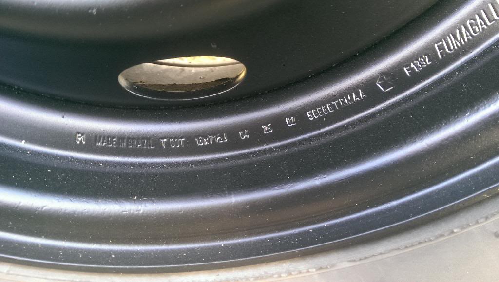

Well fellas these wheels are indeed 16x7.5 so i guess I get to keep them for a while!
I'm gonna look up the part number but I don't think these are second gen rims at all.

Yep 305 would be good too But my steel wheels arent wide enough for that.

Gen rule is rim width plus 3".
