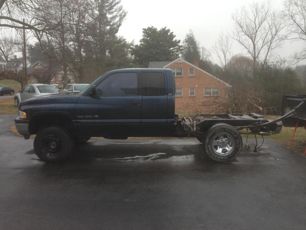

Bed is off. I'm thinking fuel pump? And some kind of chassis coat while Its off? And replacing the brake line that goes by gas tank? Anything else yall would recommend?
I was suprised by how much dirt there is. I'm gonna power wash it when the weather clears up.

Yeah wash and wax the back of the cab lol. Me I would pull the fuel pump and at least clean out the gas tank, I know what I have found in mine. You have a good list so far.

Sounds like a solid list ya got there man, maybe while its off inspect all the wiring as well, catch going wires before they cause problems in the future. if there is any aha. I think its pretty cool to see everything from above the box. How long did it take to remove?

I have Half a pint of Por-15 left. Would that work we'll? Or should I got get some cheap can stuff
I am definitely putting a new fuel pump in. This one is original and at 212xxx. If I left it it would go out within a week of putting the box back on
Aside from messing with one last bolt too long before just grinding it off. It took about an hour. Leisurely
