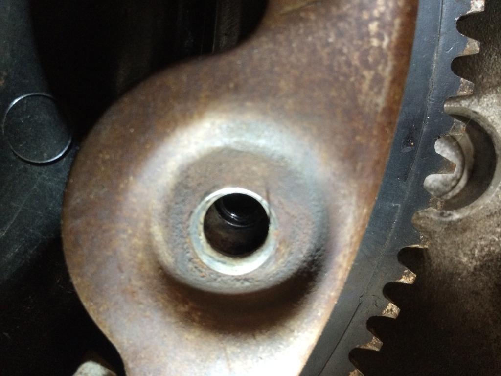

I can't get one of the converter/flexplate bolts to line up. I tried every way, but this one never lines up. The pattern must have changed over the years between my old 95 5.2 and the new 99 5.9. Is it okay to grind the hole so it lines up?

Snow, you can't grind those, everything has to be balanced. Are you using the 5.9 or the 5.2 flexplate? It has to be the 5.9 flexplate because they are balanced differently.

It's a 5.9 flexplate. There is a weight on it. I was hoping that little bit I grind off wouldn't make a difference.

Is that the original 5.2 torque converter? If so, you are prolly gonna have to replace it. Grinding it so the bolt will fit will ensure that things are NOT completely balanced, and after the money you have invested in this project, that would be a bad thing to do....
Also, the way they balance the 5.9 changed in 96. Went from a weight on the flex converter, to the weight on the flex plate. So, you have an early model truck, with a later model flex plate, and evidently, the wrong converter for it to match up to.

So I should use my old 95 5.2 flex plate and buy a 95 5.9 torque converter? And will a $80 torque converter from oreily's be ok?
