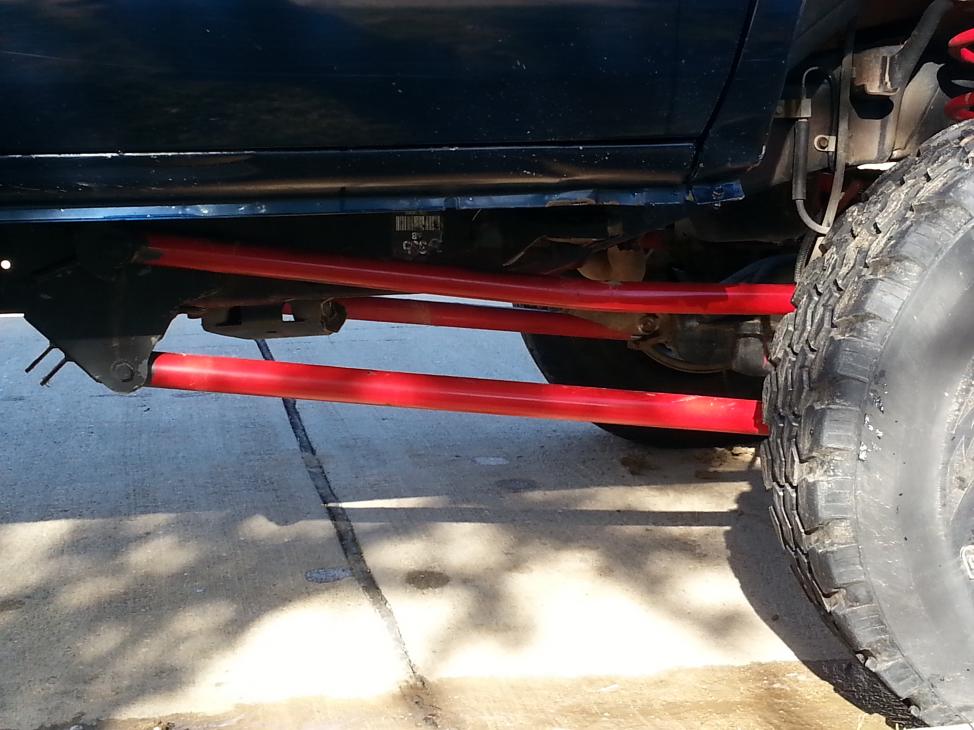

Here is the picture of it. Little worried about driving and it bending more

heim joint on the frame end, bushing on the axle end? Top Guns Customs probably has one that would work just fine.

What did you do bend it on the cab mount? Get one made out of DOM 2"x.250 wall, then cut the cab mount so this does not happen again.

I took too hard of a hit off-road I imagine. I found the long arm kit that was installed, but it's $1000 and I don't need all of the parts. I found this but all I need is the arm. http://dodgeoffroad.3dcartstores.com...94-02_p_9.html
I feel like just ordering the tubing and having the heim joints bolted or welded on. You guy have any thoughts?
