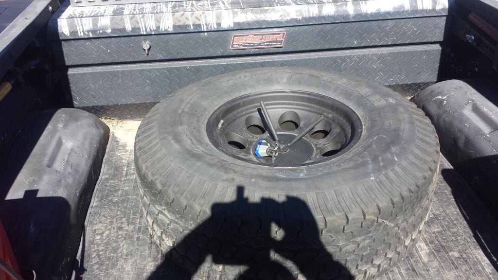

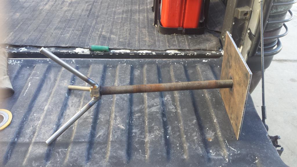

Worked in the shop today. Made the tie down for the spare tire

This design has a plate with a nut welded to it under the bed welded to the bottom
Then the bolt screws down through the bed and locks the tire in place and then with a padlock through the welded on chain link, the tire is secure

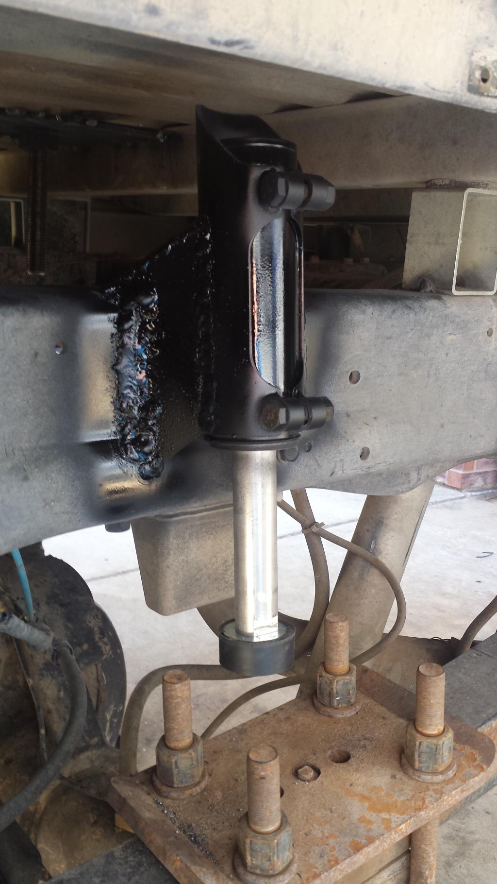

I also got the bump stops installed

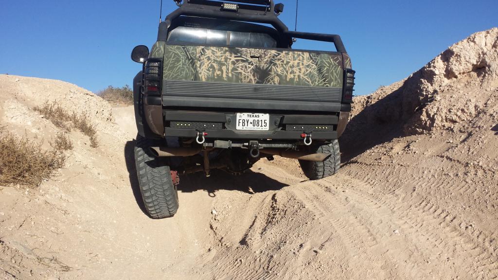

Then took the truck out and tested the stops
Got some good rear articulation and no touch on the fenders
