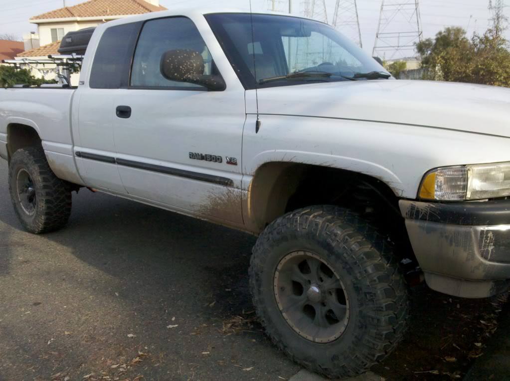

00 ORE, stock control arms, 3" body lift, 2.5" front level, 4.5" back spaced wheels, 317/70/17 Baja MTZ tires (this tire is slightly narrower (12.4") than a 35x12.5x17 tire).
No rubbing on arms. No kissing the plastic/metal inner fender.
Ran this for little over 2 years on snow and rock trails.
4" BS will touch the fender for sure.
