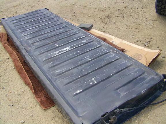

Spent about 2 hours preping by scuffing with the medium sanding block, used the scotch pad in corners, and the steal wool for rusty spots. Here it is after prep work but before tape and cleaning

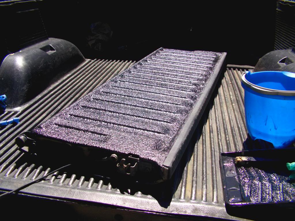

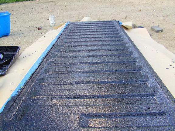

Wipped down with Xylene, taped off, and first coat down. Used the brush to blot the edges and roller for the rest.
Waited about 40 minutes for the first coat to become tackey. I then applied a second and third coat, then stood around watching for spots where it began to pool up. I would hit those spots with the roller to spred it out until it was tackey enough to not run anymore. Pulled tape 40 minutes later.

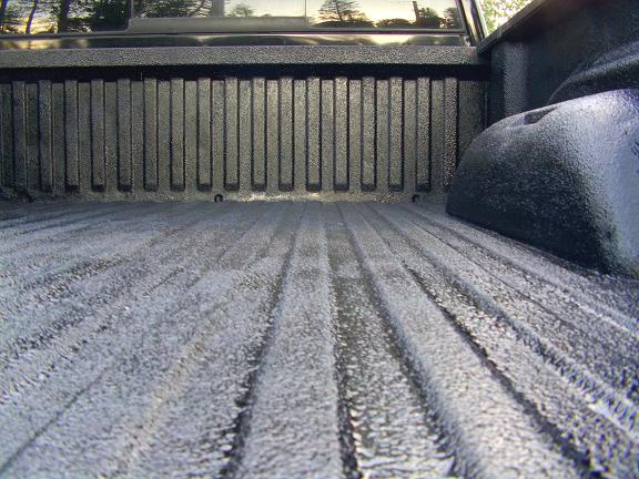

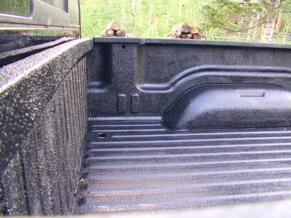

The recomended amount for a short bed is the 1 gallon that comes with the kit. For an 8ft bed it suggests the extra 1qt. I figured the thicker the better so went with the extra 1qt on my short bed (about $25).
Washed out my bed with a hose, dry, spent about 6-7 hours scuffing the bed well with the blocks, and removing rust with sand paper. I didnt have a sander so it was all by hand. I applied 2 coats to the whole bed, and a 3rd on the floor of the bed.
I got lazy no before and durring pics. Paint is still drying but here is the resultName:  IMAG0038_zps1eff91f8.jpg
