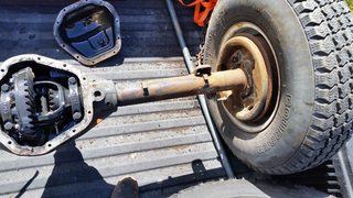

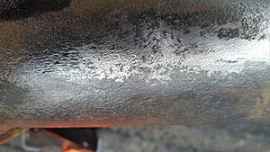

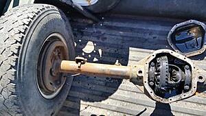

I tried taking the axle shaft out yesterday and ended up breaking a spline off my socket, I have a roommate that has an impact 6 point so I'll try that today. As for the BOM, there isn't one. I have searched the axle tubes up and down to only find surface rust. I plan on wire wheeling the entire passenger side tube to see if it got covered up with rust. Pics included if you want to see yourself.

There's a BOM on there somewhere. Who knows if you can still read it when you uncover the rust.

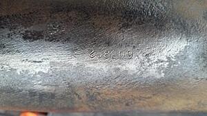

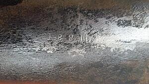

Well, I found some numbers, I had a hard time reading them so here's some picture...
'79 Dodge Dana 60 Axle Overhaul-jp6jflmm.jpg'79 Dodge Dana 60 Axle Overhaul-7pbpob7m.jpg'79 Dodge Dana 60 Axle Overhaul-pqj7ehmm.jpg
None of them looked like they were in the correct order from what I found for Dana axle id. I did get to pull out the axle shaft today and counted 30 splines so I think I'll pass since a new carrier would be cheaper, thanks for the offer though. I am honestly getting ready so that I have to flip it, I can. The only thing I didn't get done today was get a look at the brakes. I forgot that there was a nut that holds the hub on, so that will have to wait till I can bring it into the shop. I did get some rough measurments from spring perch to spring perch and they were pretty close to exact. I am going to try to get some help tomorrow to get more exact measurements and get a final answer.
