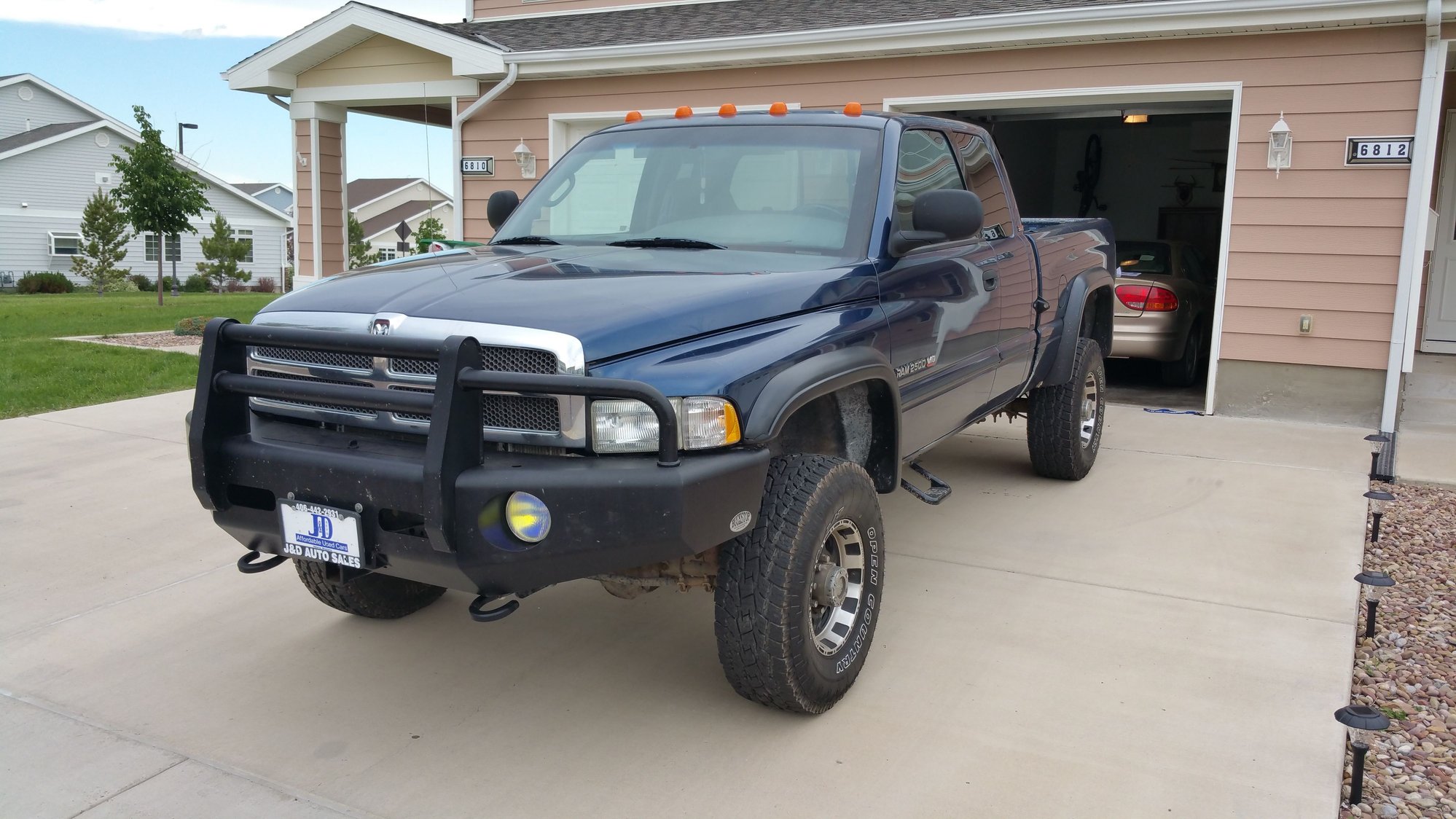

This is the truck that's getting all the toys.
