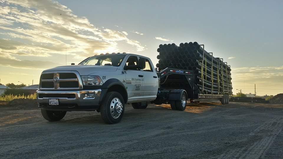

And if this forum is anything like jeepforum, somebody will demand pics of something. So here's a pic of my old truck I've been talking about.
Attached Thumbnails Looking for a pickup.-10329069_10152590241956079_1564940797446500407_n.jpg
