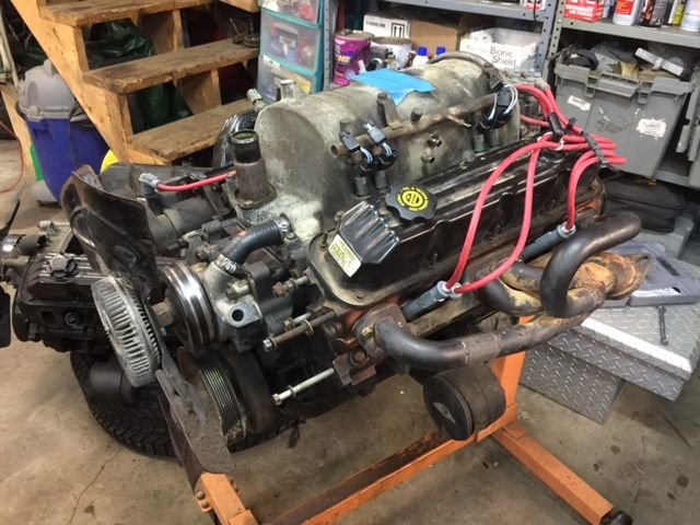

My sons (who also own 2nd Gen Dodge Rams) are big supporters of New England Rams and the Mass & Gas forums. They are always on them, buying, selling and helping others who need parts and work. They found essentially a brand new built up long block from a fellow who swapped it out for a diesel. I have the paperwork on it and he paid close to $3900 to build up this engine. He had it in his truck less than a year and put just 4K on it during that time. I couldn't pay him the $1100 asking price fast enough.
I was not impressed with the engine builders, who have a great reputation in this area. While I was prepping the engine, I found that they reused a keger that had never had the plenham redone. As a result, I swapped it out with my own keger that I had just done the plenham job, put new injectors in and refurbed the fuel rail on. When I pulled the original manifold, they hadn't even spent the few bucks to get new front and rear manifold seals! They just used a ton of RTV, which ultimately leaked, leave the front and rear of the block covered in oil.
I replaced the oil pan and valve cover gaskets (standard procedure with the engine out) and was much happier to see nice new, shiny insides and the compression and leak down tests proved that it was tight, fresh engine.

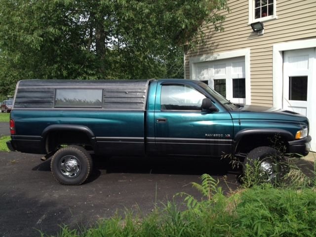

You asked for pics, so here are some. More to come.
1999 Dodge Ram 2500 ST / 5 Speed & PTO

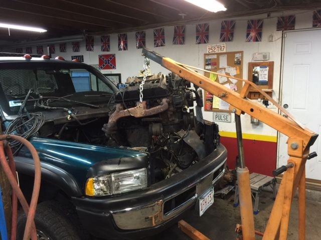

Out with the old engine
If you don't have a gasket, make one with RTV. Pretty poor on a $3900 engine job!
Fresh engine ready for installation

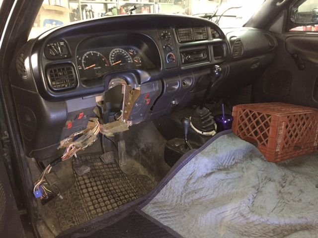

Truck sans engine
Pulling the steering column is so much easier once you've taken the seats out. (New seats going back in).
