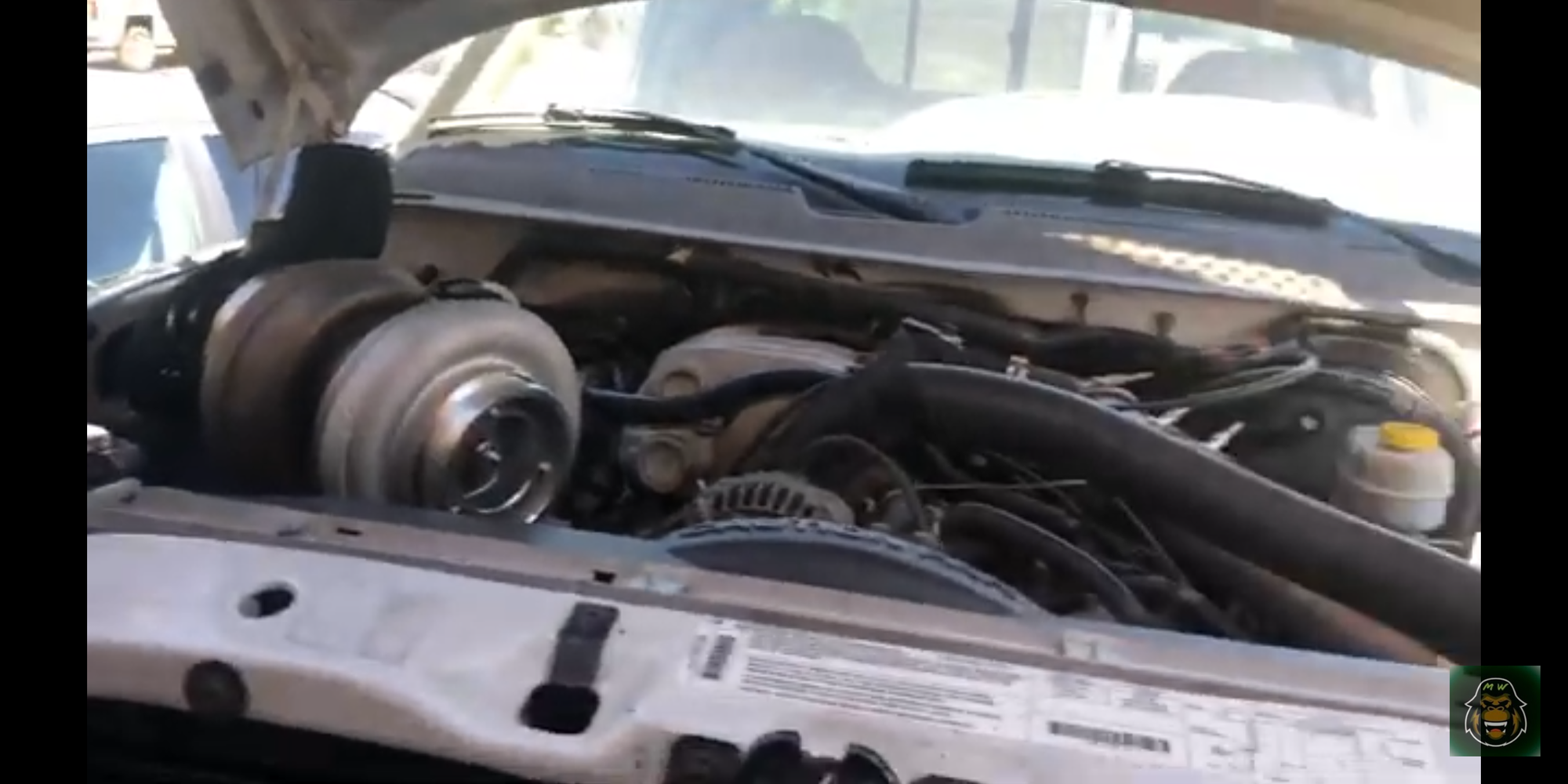

Posts: 9
Default Turbo
I plan on doing the turbo come spring, buddy gave me a hx40 that needs a rebuild and another buddy has a intercooler and piping I need
Hardest part is connecting both sides into one then running it to the turbo. Not much room in the engine bay with a V10 and I'll be curious to see how you did it.

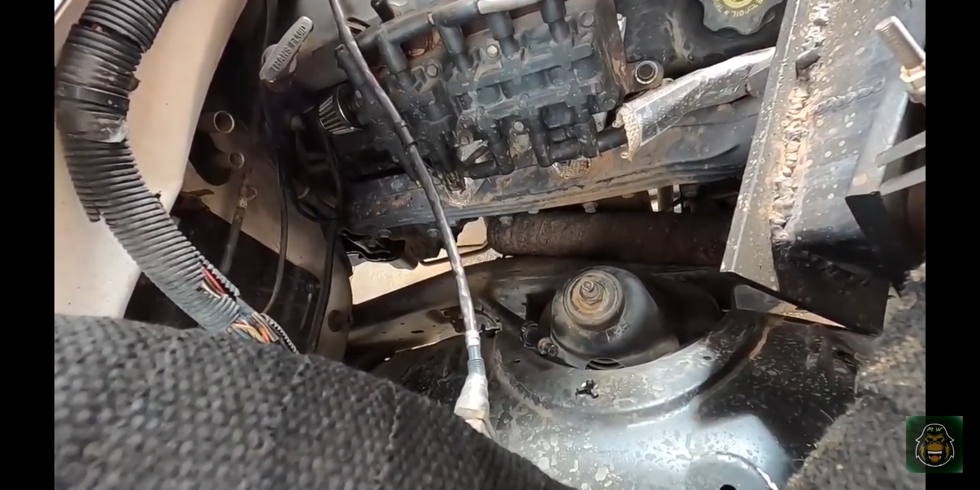

Posts: 9
Hint, run drivers side manifold/exhaust under engine to pass side, upsidedown pass manifold and spacer off block, then collection chamber to turbo
