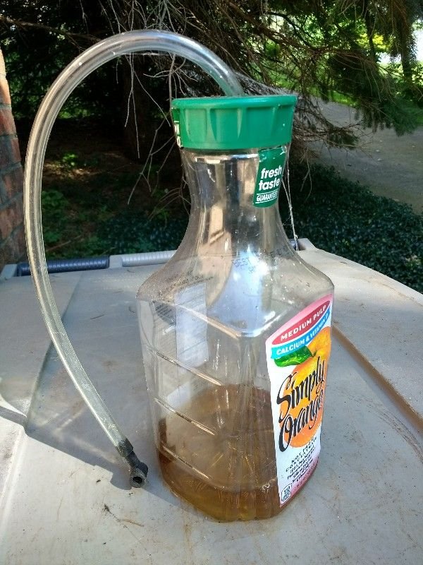

Just making sure you understand the OJ container and hose method. This flushes all the old fluid out of your system This is a one man job. You put fluid in the OJ container initially so you don't pick up air when you lift the pedal. If you don't prime the OJ container, then its the same as using two people and a catch can.
Here is a detailed play by play:
Prime the OJ container with a couple inches of fluid
Place clear hose through top of container, submerged in fluid
Open bleeder screw, and push hose over it.
Check master cyl, make sure its full, put cap back on.
Jump in the car and start slowly pumping the brakes
After a few pumps, refill the master, and check the tube for clear fluid
keep going until you see clear fluid in the tube, at that point - close bleeder and move to next wheel.
OPTIONS:
Get a turkey baster from WalMart and suck out the fluid in the master cyl and add fresh fluid before starting procedure.
I've been doing that for a long time, and since it didn't happen w/o pics, I just noticed the spider webs on the bottle... hahahha, its been a while since I've used it... but here you go. Mine is a little fancy, I have a 90 fitting on the bleeder end - but its optional.

The problem with the OJ container method is old fluid will be sucked back into the brake system when the pedal returns to the upright position. The #1 rule I was taught when I first learned how to work on brakes is to ensure the bleeder valve is closed before the pedal returns to the upright position. The OJ ( or bottle) method is good when there are two people are working on the brake system and the person with the bottle can observe for air bubbles.
Yes, the bottle method will suck some fluid back from the bottle, most of it though, will come from the master cylinder. It's not a perfect method, but, it does indeed work. I have used it more times than I can count.
Observe the air bubbles? Oookay... but if I am two man bleeding, I just cycle the value and let it squirt it out until I hear no more air spurts - then I know we are done. If there is a bottle in that scenario, its just a catch can. And I would be using a catch can if I were flushing they system. The trick here is when the bottle is in use as specified, it extends the system to include the hose and bottle. A few pulses of the pedal pushes all the air out of that hose and now you're just transferring fluid out of the cylinders and into the clear tube. You are done when the fluid goes clean in the tube. Always be careful you don't empty your master when performing this operation.
