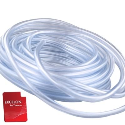

Use some clear tubing, (makes life easier to see what your fluid looks like) and stick it on the end of the bleeder valve. Make sure you get a good seal with the tubing, and around the threads of the bleeder valve. (teflon tape.....) Run the other end of the tubing into a suitable container, with an inch or so of brake fluid in the bottom. Do one wheel at a time, in the usual order. Once it is set up properly, just leave the bleeder open, and pump the brake pedal a few times. Look at the tubing to see what you fluid looks like. Still dirty? Pump it a few more times. (don't let the master cylinder go empty though.....) When the fluid is nice and clean, to your satisfaction, close the bleeder valve, move on to the next wheel. (empty some of the contents out of the container, don't want it overflowing, also use something large enough that it won't be in danger of falling over if someone (something?) looks at it wrong.

Take the bleeder screw to the hardware and match it up with about 3ft of clear vinyl tubing. Hit the grocery store and buy a container of OJ... Drink the OJ - wash it out with water, then drill a hole through the top of it, matching the outer diameter of the hose you bought.
Put some new fresh fluid in the bottom of the OJ container, plug the vinyl onto the loosened bleeder screw... then pump the brakes and adding fluid to the master until only clean fluid is coming through the clear tubing. Close the bleeder, move to the next one. It won't take as long.
