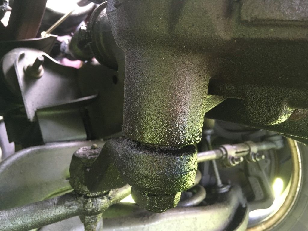

Check where the pitman shaft comes out of the steering box, is it wet?

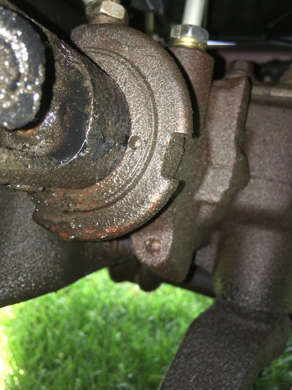

Looks like it's leaking around where the steering shaft goes into the box. Drop headed for the ground while I was looking. Doesn't look like it's leaking at the pitman arm shaft, but there is so much oil around, it's a wonder it hasn't lubricated the brake rotors. Tie rod joints definitely well-oiled.

Neighbor came by Saturday morning (in his 4th gen standard cab long bed). He ran his own shop, did mechanical, body, modifications and hot-rodding.
After poking and prodding and wiping oil, we went for a drive. The verdict was the reservoir was leaking but considering the age of the truck, I would be better off with another pump. He didn't detect any issues with the steering box, though the truck could use a front-end alignment. The various pivot points were well lubricated from the fluid leaks. That will be next week's job.

Went to Advance Thursday, bought new Carquest branded made-in-china pump. Installed it today along with a fluid filter. No leaks. So far.
Old pump was leaking at bottom of reservoir where it mates to pump. The drive shaft seal was not leaking. Former Mechanic Neighbor loaned puller/installer tools, still a bitch to put pulley back on.
