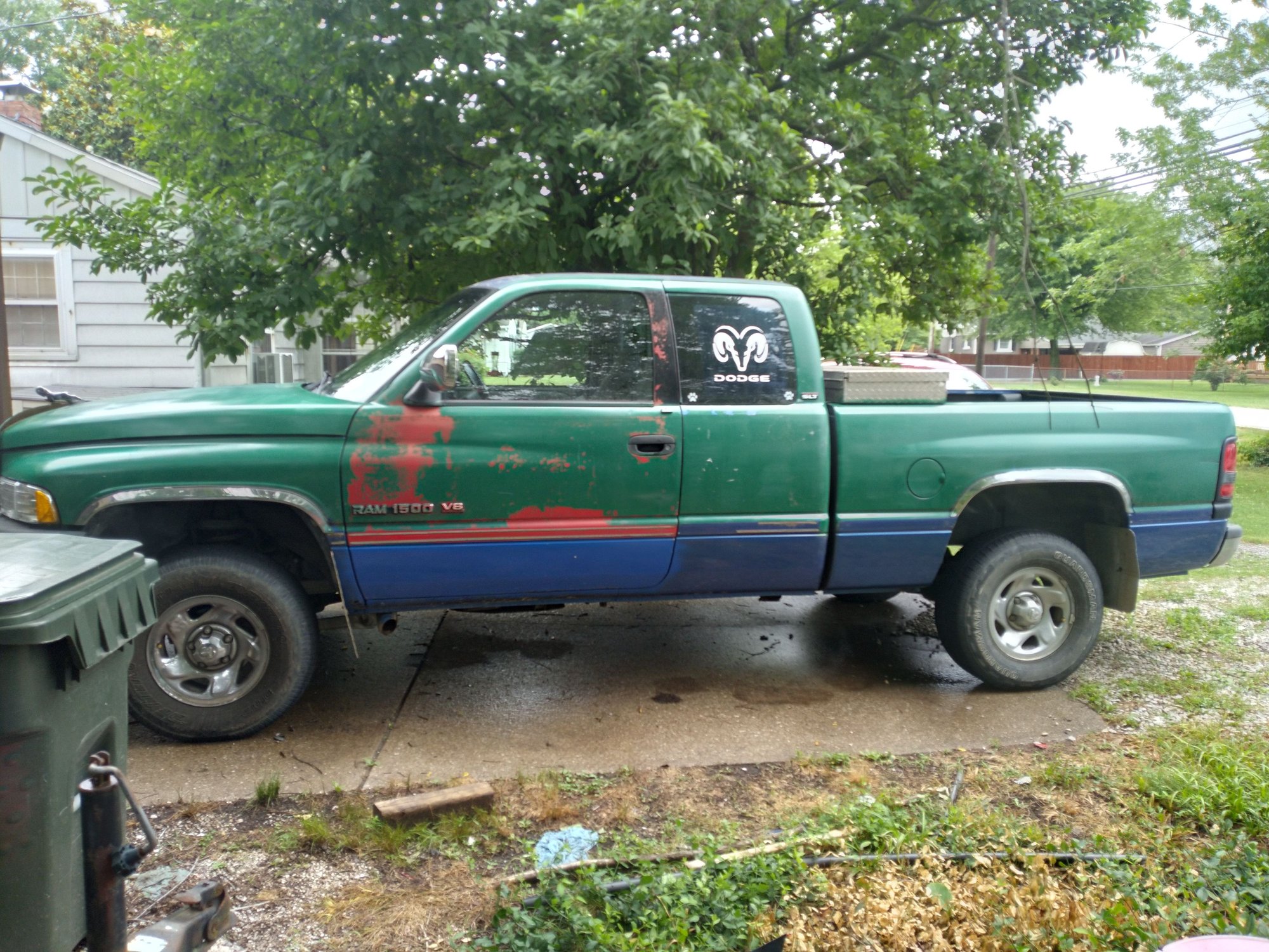

I always try to find a matching color part when possible.
It just looks neater. On the other hand, when it looked like this, NOBODY cut my truck off in traffic.
