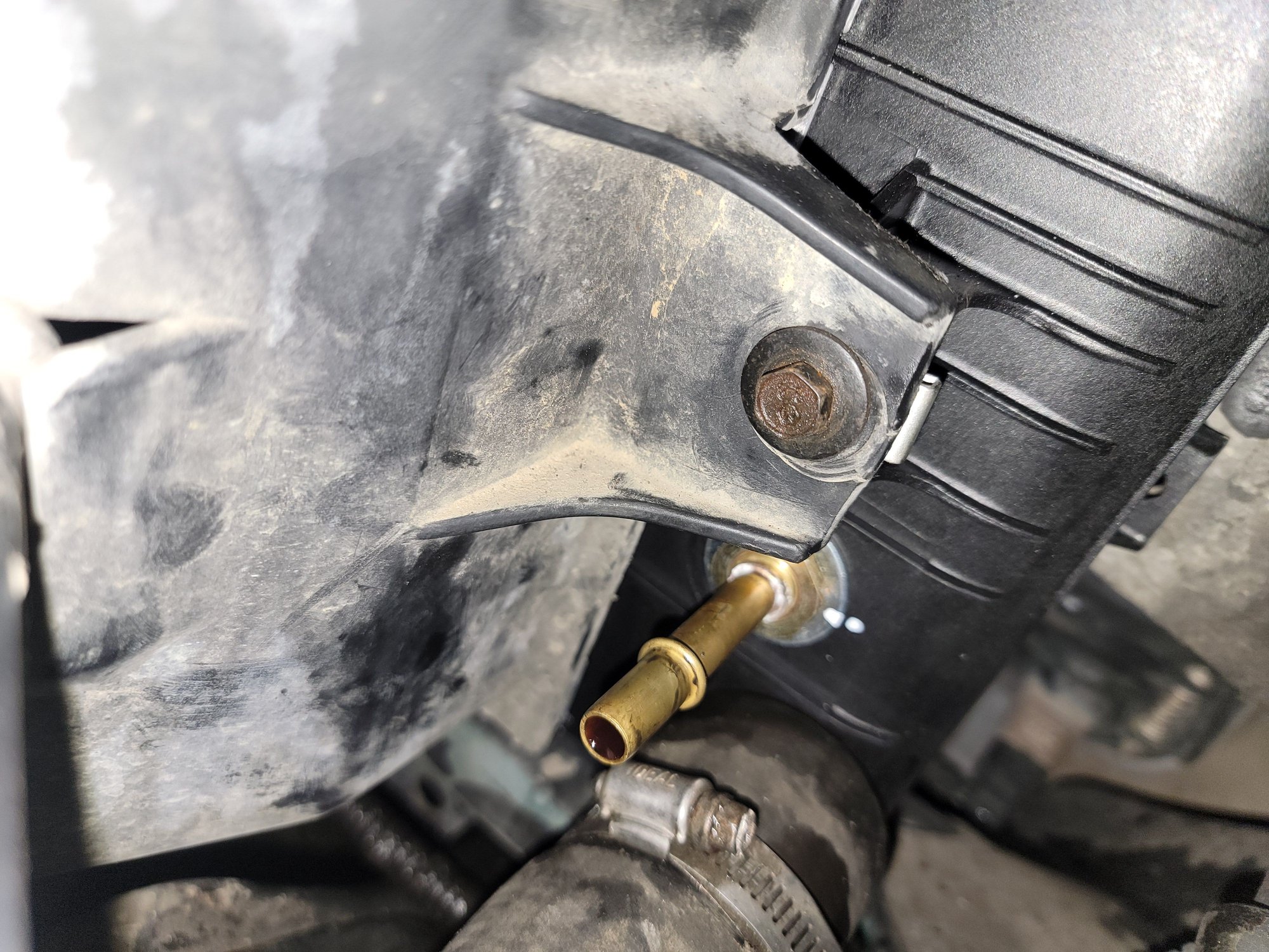

Heres a picture of the current setup right now. First pic is the original part that was connected to the hose and hooked to the old radiator. The second picture is the the line coming out of the radiator I need to connect too. Ive been seeing reviews of the Carquest Premium Radiator having suppose to come with a hose to connect to the radiator and i talked to the manufacturer yesterday. they are having a part come in soon for me and i hope its the right piece. Ive had this battle with Advanced Auto for 3 weeks. The past 3 weeks I just ran the hose over that line and clamped it on but it blows off like every other day and I loose tranny oil because of it

The fitting in the radiator IS for the quick connect. That is the correct piece. The part you are holding in your hand though..... I assume the crimped portion is where the hose came in, but, I don't see a good way for that to connect to the radiator?

Yeah Carquest is hopefully sending Advanced Auto the correct quick connect setup. I think the piece is already built into the hose so all I should need to do is connect to the quick conncect and then screw in hose onto the other end, it should come with the fitting built in on the otherside I hope. Its just dumb because every auto parts store I went too couldnt figure out what the hell a quick connect was or couldnt get what I wanted.
