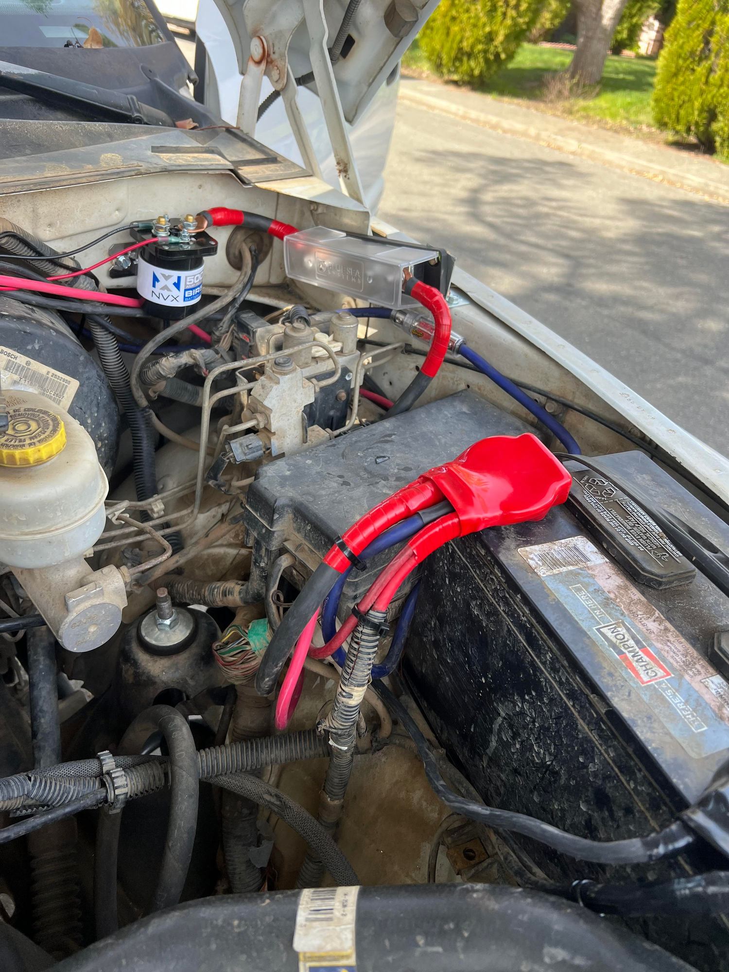

Okay gents, I got my free Warn M12000 winch and the bumper should be done soon.
For the winch I am wiring it to a 500A fuse, then a 500A solenoid for power cutoff. I don't want a fire in case I get in an accident or mash my bumper.

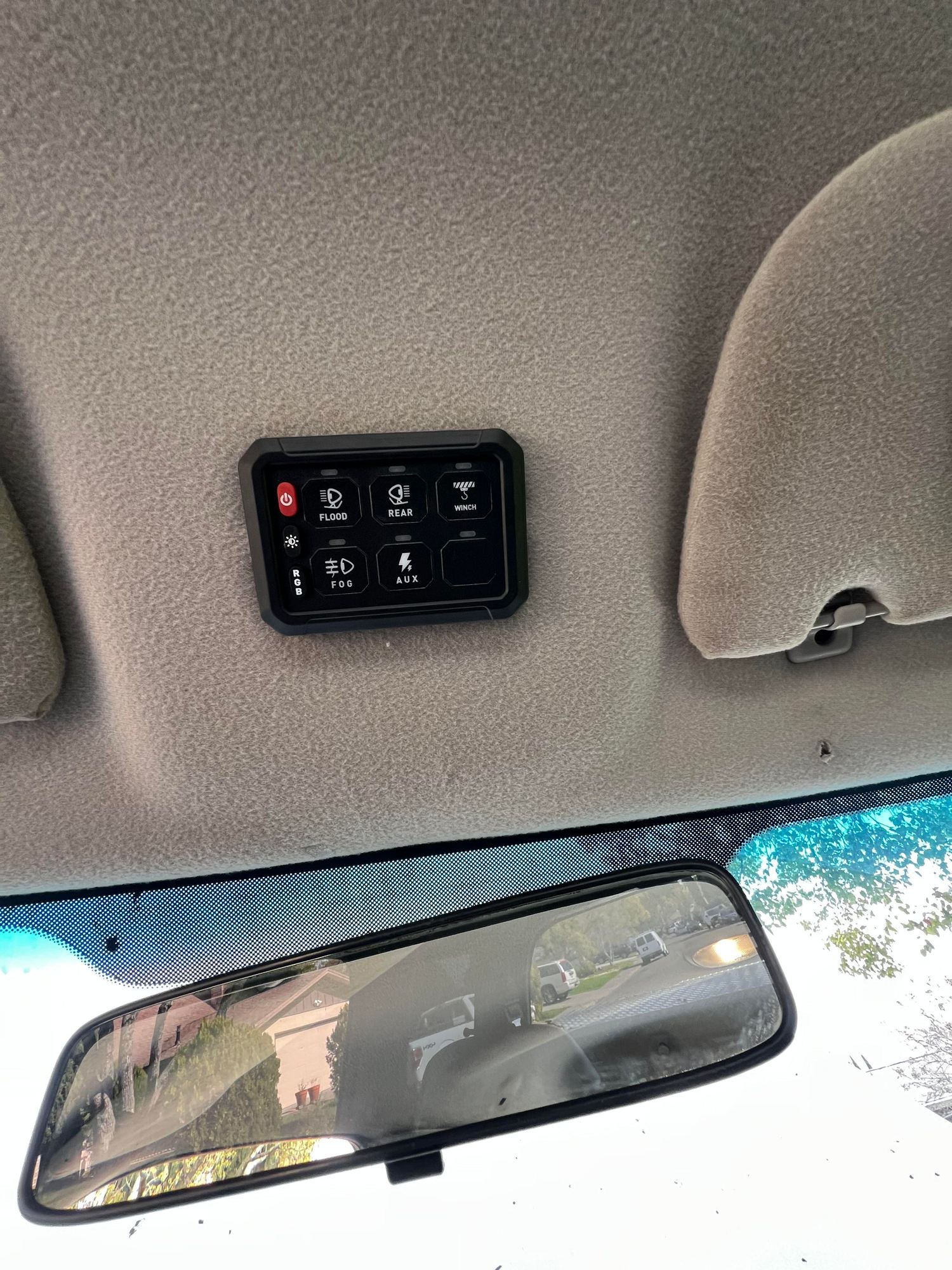

I bought all the parts for re-doing my electrical. New battery terminals that support extra cables. A 6-gang switch panel for my fog lights, flood lights, rear lights, and winch power cutoff with some room for expansion. Also relocating my amplifier fuse to the front.

This looked a lot better in my imagination. The major problem was not having a good spot to put the 500A fuse, so it had to go in diagonally and on a bracket. I think the ideal situation would be to get a second battery on the passenger side with my all my auxiliary stuff mounted there as well.
Anyway, I got bigger battery terminals. I cleaned up the original battery wiring with some vinegar and a wire brush, then I replaced the copper lugs. The starter turns over much faster and engine starts very quickly now. All my auxiliary stuff also has copper lugs with heat shrink and tape. Amplifier fuse moved to the front. Added the 500A solenoid for the winch cutoff, added a relay/power distribution panel for my lights and such on the passenger side. All the wires running along the cowl will be put in some plastic loom when that comes in.
Switch panel is mounted to a backing plate behind the headliner. Was a little bit tricky peeling it back, but the results were totally worth it.

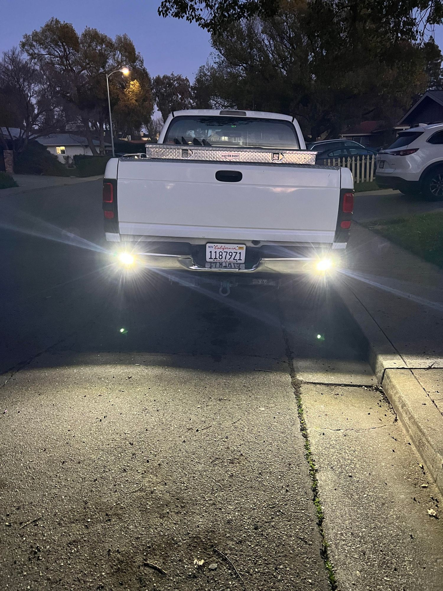

I always like to add rear facing floodlights for reversing in the dark. These were just some tiny surface mount "rock lights" from Harbor Freight.

You can get a factory aux battery tray and such for these, as the diesels actually came with 'em. May have to move some stuff in the passenger front corner of the engine compartment.... but, aside from that, it's a direct bolt-in. If you go that route, a battery isolater would be a very good idea as well.
