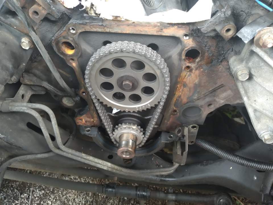

Lastly the plenum. You didn't say how many miles on the engine. My speedometer drive pinion is for a 3.92 rear end and I have 3.55 so my speedometer read high. When my plenum blew, the odometer read 168,000 miles but the timing chain looked more like 150K or so. The oversized tires make it rear right on the money. If you need to repair the plenum, I went ahead and went over the engine. I didn't pull the heads or exhaust manifolds, but everything else on the top and front of the engine came off.
The truck had been using a quart of oil every 600 to 700 miles. My oil sending unit was seeping causing the oil consumption. I replaced that, as well as the cap, rotor, plug wires and plugs, with the distributor in place, the fuel injectors, and went into the timing chain area. This involved removing the water pump and when I did that, the hoses mostly looked good BUT, the bypass hose was soft and squishy and just waiting to fail. This is that little hose that always fails when it's right around freezing and it's raining when you have to fixe it.
So check the bypass hose on the water pump.
While I was in there, I noticed the harmonic balancer was coming apart. I replaced that. The timing chain itself had some slop but might have lasted a little longer, but I was in there so it got replaced. I went with a double roller and it will outlast the rest of the truck, maybe even me. (I'm an Olde Pharte)
I had removed the radiator, all the hoses and with the water pump and everything out, there is plenty of room to stand in there to work on it. When it went back together, I used a new water pump, even though the old one was good, because, why not?
One caveat on tear down. The intake bolts are torqued down in very light tightness. I found two broken intake bolts. I managed to get one out with an EZ out. The other I had to drill. I ended up using a Helicoil kit to replace it. Lots of towels were used to keep metal particles and crud from getting into the engine. I also replaced the valve cover gaskets to stop some seeping there. Again, why not? I even found the tika tika tika noise it made when idling. There was an old flattened beer can under the intake along with some oil soaked cigarette butts.

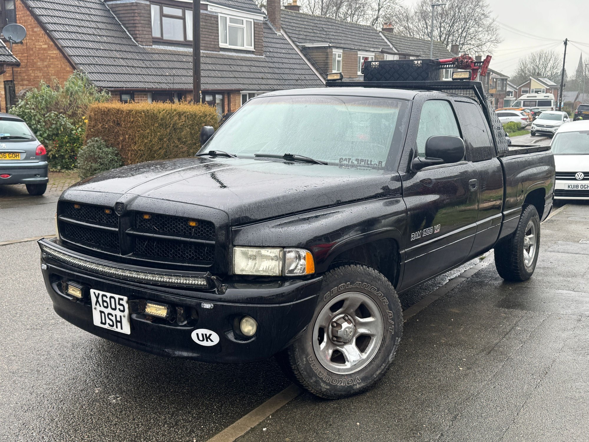

Bought it!
I bought it! Drove absolutely brilliantly. I'll post some better pictures when I pick it up next week.
I presumed it was a grey/gray import from new because it carries the correct age number plate for a 2001, but I dug around and it was delivered new in Belford, NJ, and imported to the UK from Florida in 2016.
Old Jan 25, 2026 | 11:02 AM
Posts: 87,586
Likes: 4,237
Wow. Nice lookin' truck. And, of course, it's raining.
Old Jan 25, 2026 | 12:23 PM
ocarps's Avatar
ocarps
Joined: Jan 2026
Posts: 15
Thanks. Really not keen on the third gen wheels but I can forget about finding some factory rims in the UK for a decent price.
And of course! I do my best car buying in the rain. I can't see any of the scratches so I'm more tempted to buy.
