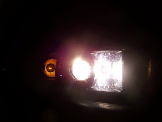

  #30
Lightninram's Avatar
Lightninram
Joined: Jun 2007
Posts: 35
Default RE: Re-wiring the eBay projectors
Halos
Halos and Fogs
Pros, Halos, and Fogs
Highs, Pros, Halos, and Fogs
