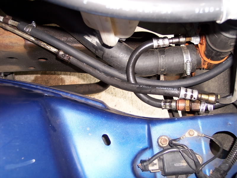

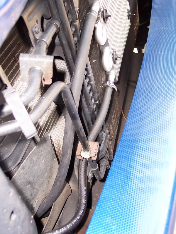

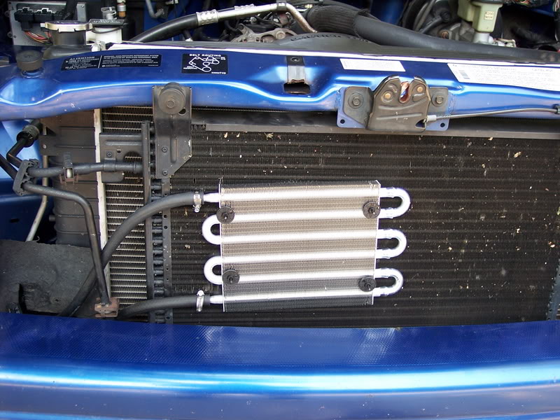

Old Sep 7, 2007 | 01:35 PM
IndyRamMan's Avatar
IndyRamMan
Joined: Nov 2006
Posts: 2,902
Default RE: trans cooler installed.
Theres your stinkin pics (try to count the bugs)
now that im thinking of it,theres no need (or way) to purge the added air in the system, is there?

not necessary. the transmission pump will shoot fluid all the way through it within about the first uumm, 10 seconds of operation, and the air will return to the transmission pan, and presto, its gone. in fact - its already gone.
is your routing from transmission (hot) -> external cooler - > radiator - > trans (cool) ?
is that the check valve still in the line ? did you mean to leave it in.

My question wasnt if it was working or not, because I know it is, but if for effieciancy of the system's sake, it would be better.
yea, I wanted the valve in there.
