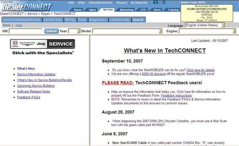

ORIGINAL: VWandDodge
You should work on your troubleshooting skills rather than just replacing parts for the sake of replacing them. Oh well, it's your wallet. Check out my "Overheating" thread. People told me to just barrel in there and replace the head gaskets. #1, that's a bitch, and #2) the symptoms didn't match the problem. In the end, it was the waterpump that was the issue. You have to learn how to think these things through.
X2^
check your plenum like i said earlier
when the oil is heating up in the intake, it is thinning out and and being sucked into the engine and making it run like crap.
very simple to check
also could be the Sync Signal is out of spec.
i dont think you can check that with a standard scan tool
u would have to have the DRB to see it
its the electronic "matching" and sync of the timing comparison between crank and cam sensor - since it is electronically controlled and slightly changes - but cant take but so much... it wont set a code for just this (sync) normally it would just run like crap and it CAN set codes for cam and crank sensors
-had one come in for running like crap, he said he had replaced the heads, and didnt know why it was runnning like it was.
=checked sync - it was like 15-20 degrees off, - rotated distributor(it was left loose)
sent on his way
it still couild be the crank sensor; they just go bad-no real reason- i'd say heat gets to them internally- torque converters do get pretty hot... - located on bellhousing of tranny, back of engine, drops into bellhousing, surrounded by a rubber gromnet, bolted-holding it down - 2 bolts, pita to get to sort of unless you have a body lift
there is a thread somewhere on all details
i can help alot with the codes and more
i need the last 8 of your VIN
PM me if u want
