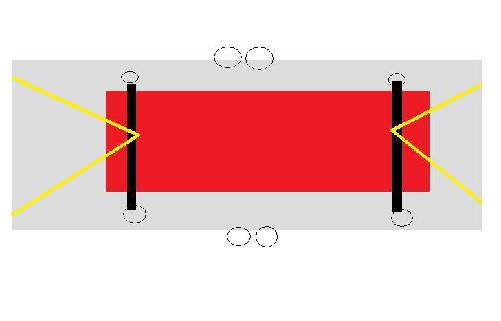

Well for putting the car on the trailer (I see you are using a full trailer now).
Try to center the vehicle above the axles. For strapping down, on my jeep I use straps around the axles. No clue what the suspension setup is on the vehicle you are towing but if solid axles you can use them. If not see if you can find factory tow points on the vehicle, frame, or anything solid.
Excuse the TERRIBLE paint drawing
