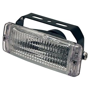

resurrecting this old thread for another round.
the Northern Tool lights didn't hold up worth a damn. they'd last 6-8-12 months and then die. I've been through 2 sets and they're out again.
Trying again with a different set of lights. Hopefully they will last better. I think i'll run a power wire and a relay this time.
