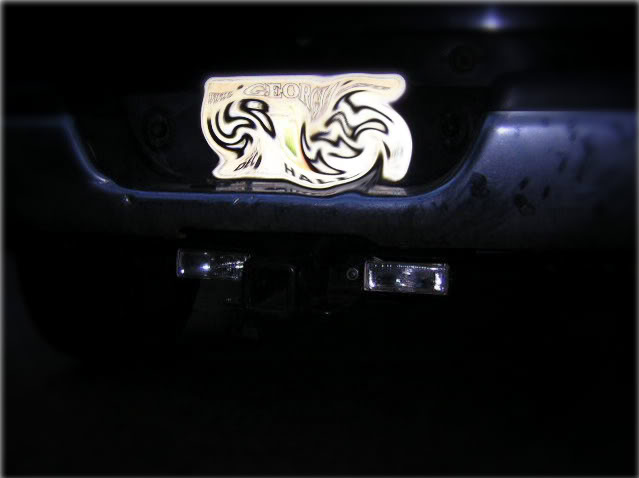

I couldn't see anything with the factory backup lights. I got these lights at the Northern Tool (Northern Industrial) store for about $7, although they are listed at $10 here.
http://www.northerntool.com/webapp/w..._352681_352681
They are small, about 4-5" long and a little less than 2" tall. They come with brackets and drilled and tapped holes in the case for mounting. I bolted them to the sides of my receiver hitch and wired them into my backup lights. no relays, no switches, nothing fancy. put it in reverse and these things light up the world.
i also discovered a wiring surprise. i had noticed that i blew the backup light fuse frequently, but had not figured out why. prev owner had provide 4 pin trailer lights. so i probed them per normal testing and the bare pin was not a gound like it was supposed to be. hmm. more probing - bare pin was wired to the backup light circuit. wow (and how convenient). so i clipped it loose, and tied it into my lights, and took a ground from the receiver hitch to bare pin (and light ground) and were done.

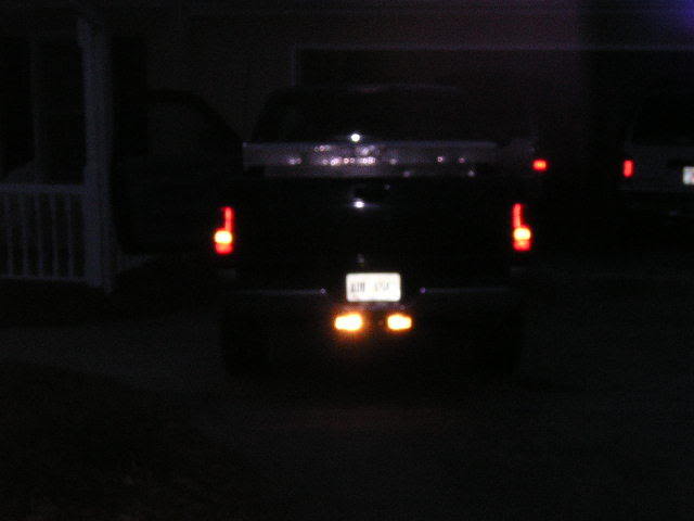

also now that you argued with me wayne you forced me to go outside in the rain and take some pics of mine, to show how much bright it is to wire them from a direct 12 volt (right off the battery) with a relay, vs the light out put from dhvaugh's setup.
his....
MINE...
HIS SIDE VIEW...
MY SIDE VIEW...
I HOPE YOU GET THE POINT....

also ill include 2 more pics with my stock reverse lights on as well.
